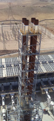

AES Levant Power Plant
AES Levant Holdings BV Jordan
250-MW, tri-fuel, peaking facility consisting of 16 diesel engines located in Al Manakher, Jordan
