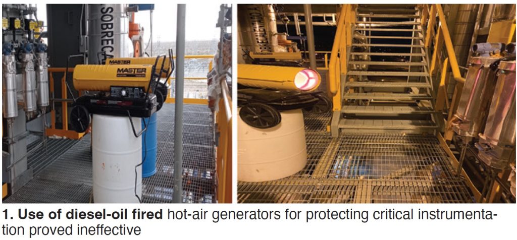

Solution. In 2021, a year after the plant began commercial operation, diesel-oil-fired hot-air generators were installed to reduce the impact of low temperatures on critical instrumentation (Fig 1). However, this solution was far from ideal. One reason: O&M technicians had to supply diesel to the hot-air generators every couple of hours to keep them in service.

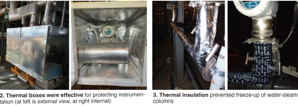

Encapsulating in thermal boxes all transmitters working with water/steam column lines was the solution, along with thermal insulation of exposed lines (Figs 2 and 3).

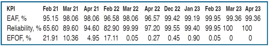

Results. The table tracks historical EAF (equivalent availability factor), reliability and EFOF data and shows the dramatic improvement gained by migrating from the hot-air generators to the insulated lines and cabinets. The migration was completed early in 2023 and highly successful, as evidenced by comparing the data for January and February 2023.
Another plus was the safety, environmental, and cost benefit of eliminating the diesel-fired hot-air generators.
