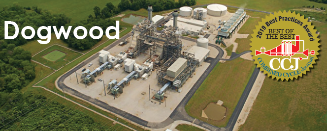

Dogwood Energy Facility, Pleasant Hill, Mo, like many other combined cycles, opens its steam-drum doors on a routine basis to perform internal inspections. While properly aligning and closing the doors at the end of an inspection is a challenge in and of itself, the larger challenges and risks often are associated with making sure the gaskets do not get damaged during installation and that a good seal on the drum door has been established before removing the LOTO and lining up the HRSG for operation.

The best practice described below and the plant’s method for eliminating the risk of hot torqueing steam-drum doors, described in an accompanying article, earned Dogwood Best of the Best recognition by CCJ and the 501F Users Group in 2019 Best Practices Awards program sponsored by the journal.
Dogwood is owned by Dogwood Energy, City of Independence, Missouri Joint Municipal Electric Utility Commission, Kansas City Board of Public Utilities, and the Kansas Power Pool. The facility is operated by NAES Corp; plant manager is Steve Hilger.
