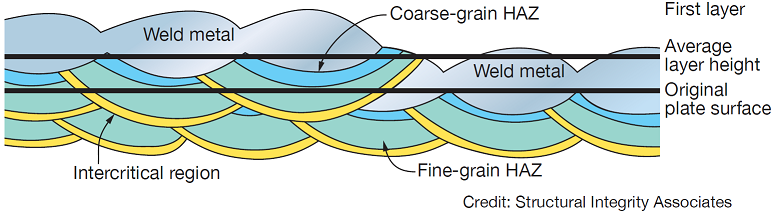

Cold welds. One of the document’s 13 chapters is devoted to cold-weld repairs—defined here as weld repair where preheat may be applied, but PWHT is excluded. The technique may help users mitigate the financial impact of lost production by allowing units to return to operation sooner than they would if PWHT were required.
Cold-weld repair technology was pioneered in Russia in the 1960s and later advanced in the UK. The US National Board Inspection Code in 1977 allowed weld repairs without PWHT for several materials provided specific buttering techniques were used. In 1995, the NBIC accepted that certain welds were impractical to PWHT and allowed cold-weld repair provided the owner/operator could demonstrate properties equal to those for the original construction.
Several controlled weld-metal deposition techniques were developed to enable cold-weld repairs. They use the thermal fields, generated by successive weld beads, to provide both the grain refinement necessary to assure success as well as some local tempering of the structure of the heat-affected zone (HAZ). The so called half-bead, temper-bead, and heat-input control techniques all are based on controlled overlap of the adjacent weld bead segments and the use of several buttered layers. The temper-bead technique some prefer for cold-weld repairs on P11 and P22 is illustrated in the figure.

Keep in mind that toughness of the HAZ and weld strength depends significantly on use of a welding technique that minimizes the coarse region from the parent metal. Bill Kitterman, GM, Bremco Inc, oft noted by users for the quality of its weld repairs, extracted relevant material on the art from the company’s files that has been collected over the years. A passage published on www.gowelding.com suggested the following:
“The first layer of weld should consist of small beads, deposited using low heat input to ensure minimum penetration into the parent metal. This can be achieved by using small electrodes, welding in the horizontal position, and adjusting the angle of the electrode to minimize penetration. Great care must be taken to avoid hydrogen cracking and lack-of-fusion defects. A 50/50 bead overlap will reduce the course-grained area, but not necessarily remove it altogether.
“Depositing a bigger weld bead on top of the smaller ones, such that its refined zone overlaps the coarse areas created by the original runs, is the preferred technique. Sometimes the first beads are ground down slightly to enable the refined zones of the next beads to line up correctly. The final bead of any welding sequence should be deposited in the middle of the cap, away from the parent metal.”
