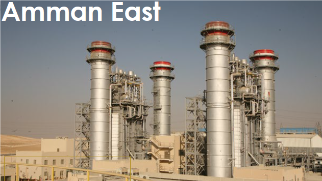

Challenge. Amman East, a 370-MW combined cycle powered by two dual-fuel Ansaldo Energia AE94 gas turbines and located near the Jordanian capital, relies heavily on oil today. The “political situation” in Egypt interrupted the plant’s gas supply in 2011.

370-MW, dual-fuel, 2 × 1 combined cycle located in Al Manakher, Jordan
