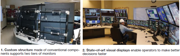

Since the four Wonderware computers could be configured to support two monitors each, the plant opted to expand the displays from four smaller screens to eight 40-inch flat-panel LED monitors. Adding four more 40-in. monitors—for displays of alarms, weather, and security cameras—plus three 24-in. monitors for each of the turbine controls yielded a total of 15 high-definition monitors.
We then had to figure out how to fit them onto the existing control console desks and arrange them in a horseshoe configuration for ease of viewing. Given the limited area on the console desks, our staff came up with a two-tiered design.
To support the two tiers of monitors, they devised a custom support structure using standard steel pipe connected with the kind of aluminum fittings typically used for hand rail systems (Fig 1).

Results. With the additional monitors, which are substantially larger and of much higher resolution, our operators have more information right in front of them on an ongoing basis. This enables them to make better decisions faster—especially in situations where they may need to act pre-emptively. The ability to react quickly to a deviation ensures more controlled, reliable startups (Fig 2).
As an added benefit, the optical quality, size, and ergonomic arrangement of these new displays reduce eye strain, which makes a substantial difference to an operator on a 12-hr shift.
