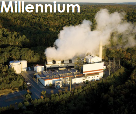

Millennium Power
Owned by Talen Energy
360-MW, gas-fired, 1 × 1 combined cycle (501G) located in Charlton, Mass
Plant manager: Mark Winne
