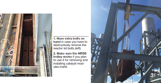

- Check to be sure you can remove the reactor lid. At one site, bolts had to be destructively removed (Fig 1) and available spare bolts used as replacements. If you don’t have spares, make sure you can obtain these bolts.

- If you plan to use the HRSG trolley supplied by the OEM during construction, make sure it is operable beforehand (Fig 2).

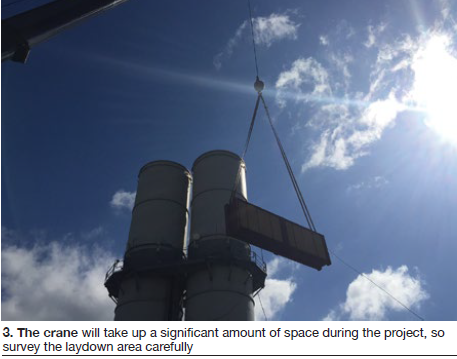

- Evaluate in detail the plant laydown area (Fig 3) around the HRSG. The crane requires a huge plot space. At one site, 20 dumpsters were necessary to hold and haul away the spent catalyst.

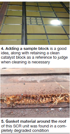

- Request that a sample block be included with each new catalyst module and hold one block back to serve as a baseline for comparison when catalyst cleaning evaluations are conducted Fig 4).
- Pay special attention to gaskets and sealing around the unit. At one site, gasket material around the roof was found to be in extremely poor shape (Fig 5).
