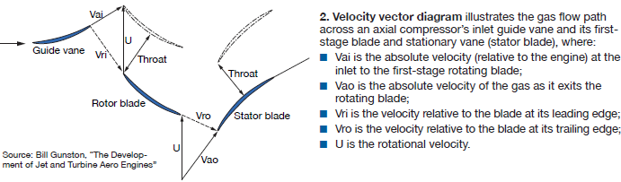

An engineer may begin the design of an axial compressor using velocity vector diagrams for just the IGV and the first compressor stage (Fig 2). They will identify the necessary air inlet flow angles for blades and stators to meet the desired operating conditions.
The resultant air-flow streamlines around a compressor blade are shown in Fig 3 (left) for the design flow angle. (The sketch for a stator would be similar, but without rotation.) Going from low pressure at the blade’s leading edge to a higher pressure at its trailing edge, the streamlines closely follow the blade’s suction and pressure surfaces.

Boundary layers are very sensitive to the conditions brought about by adverse pressure gradients, which is what a compressor produces. Thus the designer is careful to insure that boundary-layer separation does not take place at design air inlet angles.
When air inlet angles (measured in the axial direction) are increased, separation of the blade boundary layers can occur, as shown by the streamlines around the blade at the right in Fig 3. Here the streamlines on the suction side do not follow the blade surface aft of the boundary-layer separation point. This compressor blade is stalled.
