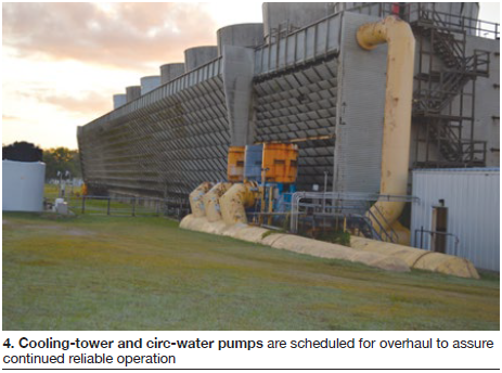

Improving reliability is another priority (Fig 4). “Switchgear, cooling tower, and circulating-water pumps, all need overhauls. Plus we have to meet the reliability standards required by Texas authorities; pass an environmental, health, and safety (EHS) audit; and implement a final solution for the steam-turbine vibration.” Obviously, there’s much on the plate as some of the equipment, like the generator step-up transformer (GSU) and lube-oil coolers, are close to 60 years old.
