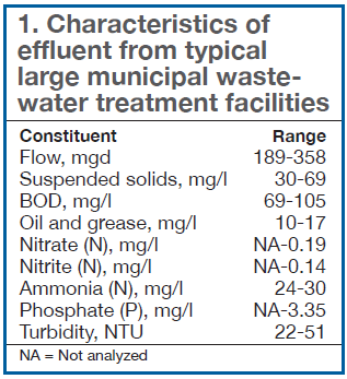

Table 1 summarizes the typical quality of municipal wastewater from four large treatment facilities. The constituents listed in the left-hand column are typical of the parameters included in an NPDES permit. Note that several of these constituents were not routinely analyzed at some of the facilities surveyed—likely because they were not regulated.
Engstrom reminds that many of the constituents of interest in cooling- and boiler-makeup water applications for scaling and corrosion potential usually are not regulated individually and not always analyzed on a regular basis.

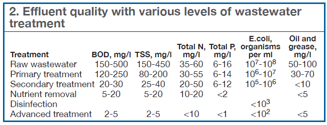

This information gap is relatively common when evaluating potential reclaim water sources and highlights the importance of collecting data over an extended period of time. Comprehensive data collection also has the advantage of capturing seasonal variations, which occur in most regions. With MRW, this variation is even more exaggerated and can be day-to-day or even in day-to-nighttime cycles with regards to flows and composition.
The wide variation in the ranges for the individual parameters shown in Table 1 is a direct result of the level of treatment represented by the different facilities. Municipal treatment facilities have a minimum of secondary biological treatment, with many either using or transitioning to nutrient (N, P) removal and tertiary or advanced wastewater treatment systems. Table 2 summarizes typical effluent qualities that can be expected from various levels of wastewater treatment.
The foregoing information assures high-quality MRW can be produced if the appropriate treatment processes are in place. In fact, water produced by an advanced wastewater treatment system is on par with most natural waters currently used.

  • Municipal plants that practice nutrient removal, advanced wastewater treatment, or tertiary treatment of their effluents provide water of sufficiently high quality to at least mitigate many of the problems described in the preceding discussion. These treatment plants may produce water of a quality at or near current fresh surface-water supplies.
  • At a minimum, the wastewater treatment facility should practice a high level of nitrification to reduce the significant performance and cost issues associated with ammonia in the water.

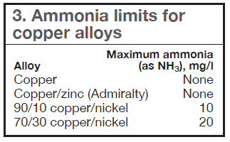

The presence of ammonia in the reclaim wastewater can have a detrimental effect on the corrosion rates of any copper alloys contained in the system—including stress corrosion cracking (SCC). Copper ions introduced into the water from accelerated corrosion also can have a negative impact on mild-steel corrosion rates because of copper plating and the resulting galvanic corrosion/pitting cells that may be formed. Table 3 lists the maximum ammonia levels that can be tolerated by various copper alloys.
These levels are exceeded by many reclaim waters not subject to consistent nitrification (Tables 1 and 2). This is a major concern for existing systems where ammonia may not have been factored into the original design. New plants should address these issues during the design phase and in the materials-of-construction selection process.

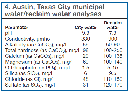

Chloride and sulfate levels in the wastewater returned to the treatment plant can be significantly higher than were present in the initial distribution water. This is the result of water- softener regeneration discharges, cycling up effects from industrial users, addition of wastewater treatment chemicals at the municipal facility, and, in some coastal areas, I&I of brackish or seawater into the collection system. The author has seen chloride levels of <35 mg/l in the distribution system with returned levels of >200 mg/l in the reclaim wastewater discharge.
Representative analyses are presented in Table 4. It shows chloride and sulfate levels in MRW for this example can be three to five times greater than in the original water. In some cases, the levels for both of these ions can exceed recommended levels for corrosion of specific metallurgy or materials of construction in cooling systems operating with relatively low cycles of concentration (COC).

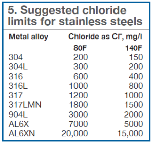

Chloride can cause stress corrosion cracking (SCC) of stainless steels. Table 5 lists suggested chloride limits for various stainless steels as a function of temperature. The recommended chloride levels would be exceeded at very low cycles of concentration for any of the less noble stainless-steel alloys used in heat exchangers operating on MRW. This would require upgrading the metallurgy for new plants during design, or retrofitting upgraded heat exchangers in an existing plant.

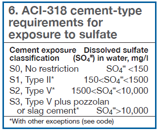

In addition to elevated chlorides affecting materials, elevated sulfates in reclaim water can impact the type of cement used in concrete in contact with the water (tower basins, for example). The American Concrete Institute (ACI) has established guidelines defining cement limitations as a function of sulfate in ACI 318 (Table 6).
There are many locations where groundwater sulfate levels exceed 1200 mg/l. These levels would be significantly higher in the MRW and could have detrimental effects on concrete used in the system when cycled during normal cooling-tower operation. This often is addressed the selection and application of appropriate coatings.
