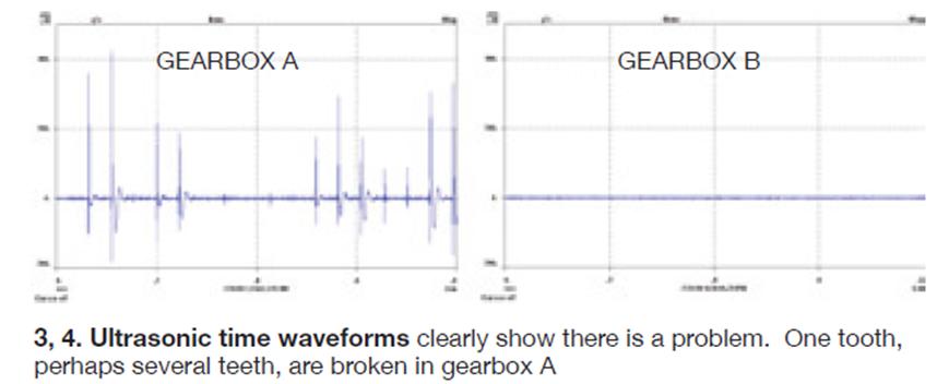

To illustrate how valuable ultrasonic evaluations can be, consider the following case study. A tube manufacturing plant had six gearboxes coupled together. Each was driving tools that bent steel to form tubing. An inspector was collecting data from the gearboxes with an accelerometer for vibration analysis and an Ultraprobe® ultrasonic translator.
When listening to the gearboxes with the Ultraprobe, five made a hissing-type sound, one a ticking sound. A time waveform was captured using the accelerometer and then using the ultrasonic translator for both the questionable gearbox and the one next to it. The waveforms from the accelerometer are shown in Figs 1 and 2.
By comparing the two time waveforms, you can see that there is a slight difference between the two gearboxes. When you look at the ultrasonic waveforms, the problem becomes more defined, indicating that there is a broken tooth (or teeth) in gearbox A (Figs 3 and 4).

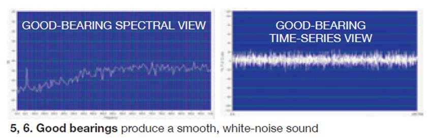

Figs 5 and 6 show the spectral and time-series views of a good bearing. If one were to imagine the sound a good, lubricated bearing makes, it would be a smooth, rushing sound. Note that there are no distinguishing characteristics: This is an example of white-noise. Now, consider a bad bearing (Fig 7). Notice the shift. The bearing is producing a jarring, buzzing noise. Note the fault frequency has been captured as 90-Hz harmonics.
The advantage of ultrasound inspection, aside from providing a finer resolution for viewing the sound image, is that inspections can go beyond what is possible to do with typical vibration or infrared scans.

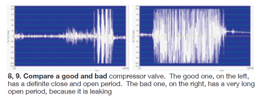

Ultrasonic evaluations can be very useful for testing valves. For example, reciprocating compressor valves are very noisy and produce a lot of extraneous vibration. By isolating the sound, with the advantage of the short-wave nature of ultrasound, it is possible to listen to and view the sounds of these noisy valves in real-time and to identify a leaking valve.
As a good compressor valve opens and closes, there will be a definite, pronounced clicking. Shown in Fig 8, a good valve will have a definite closed period followed by a distinct open period. A bad valve (Fig 9) has a very long open period because it is leaking. If one listens to these samples, the difference is very obvious.

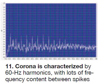

Fig 11 is a view of corona. Note the steady display of 60-Hz harmonics with a lot of frequency content between the spikes. If one listens to corona, it has a distinct buzzing and crackling noise.

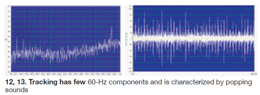

Figs 12 and 13 show tracking. Sometimes referred to as “destructive corona,” tracking has a different acoustic property. This type of emission has a rapid build-up and discharge called “baby-arcing.” Note that the 60-Hz harmonics have diminished.

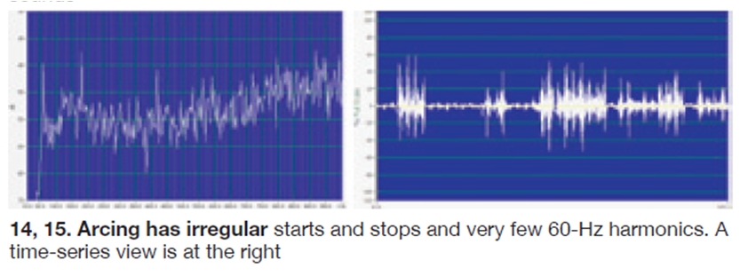

Arcing is shown in Fig 14; a time-series view is in Fig 15. Note that it has irregular starts and stops and very few 60-Hz harmonics. Arcing primarily contains violent starts and stops.
