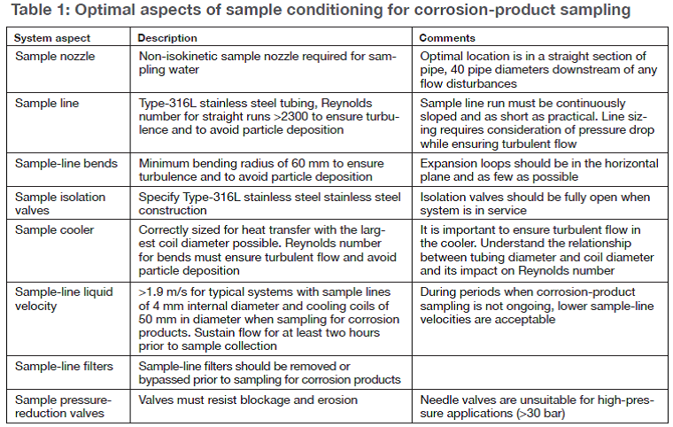

One common problem is that plants tend to sample when it is convenient to them rather than what is best for accuracy and reliability. One general criterion is that sampling be conducted at some reference conditions, preferably when operating above 80% load with the plant stable for more than two hours. This, of course, highlights one of the difficulties as many combined-cycle facilities frequently are ramped up and down in load. This is all part of establishing a clear baseline for the plant and building a reference baseline for similar plant groups worldwide.
Another common plant issue is the use of a spectrophotometer with no chemical digestion (meaning only the soluble component is detected, and not the particulate; hence, the results are lower than they actually are) of the samples prior to analysis. Digestion of particulate corrosion products requires the use of a strong acid, heat, and time. “The sensitivity of the analytical technique must be matched to the level of corrosion products in the system,” stresses Addison.
Finally, choosing sub-optimal sampling locations is common. The optimum location is from a stream of moderate-to-high velocity downstream of, but as close as possible to, the component or area of a circuit under surveillance.
Table 1 reviews the optimal aspects of sampling. Another very helpful table summarizes all the analytical techniques for iron and copper. You can check what you are doing to the critique provided. The important point is that, while many techniques are reviewed, only certain ones listed in Table 2 are considered suitable for total corrosion product levels in the ranges commonly found in HRSGs.
