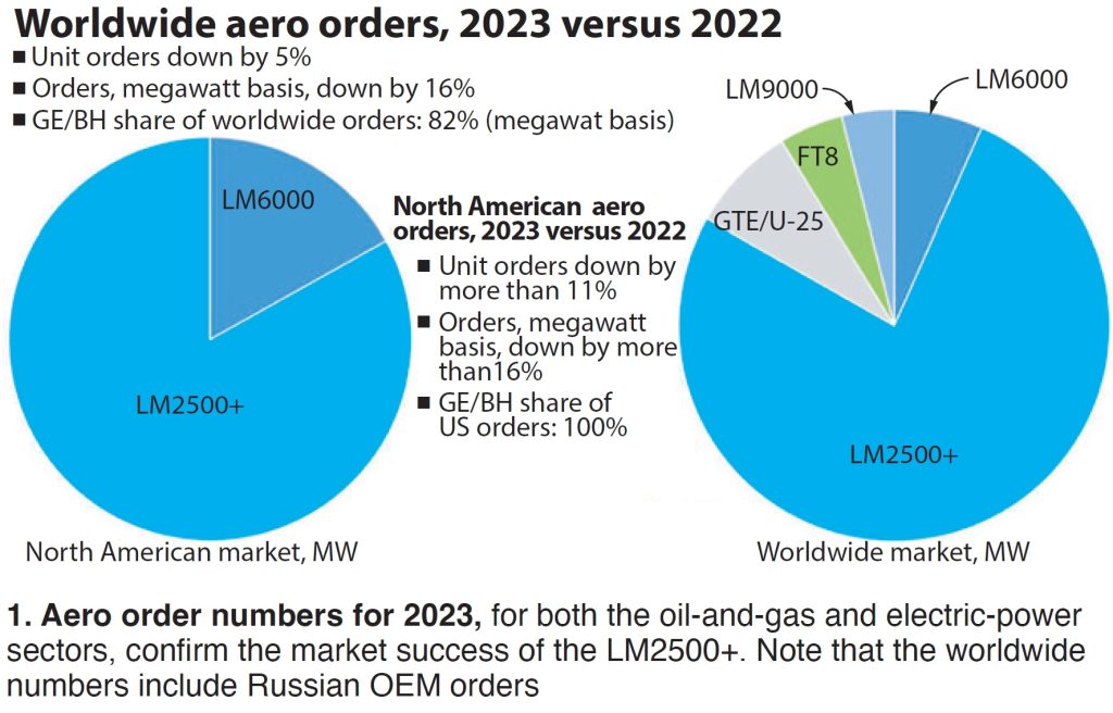

Annual global orders may have fallen 13% in 2023 in megawatts but the number of units was up slightly at 3%. Parsing out aeros from these numbers, Brough noted in his slides that North American aero orders were down 11% in units and 16% in megawatts in 2023. Worldwide, those figures are 5% and 16%, respectively.

The LM2500, which Brough described as a “market-killing machine,” (Fig 1) took 61% of the market between 2018 and 2023, up from its previous five-year share of 53%. For power generation, the machine took a whopping 81% of the past five-year market in the 30-40-MW capacity range. In North America, GE Vernova/Baker Hughes garnered 100% of the aero market and 82% of the global in 2023.
As for other models, the FT8 gets a small share in North America only in the 20-30-MW category, while the Siemens SGT-800 dominates against the LM6000 outside of the US in the 40-100-MW segment. Brough said only five LM6000s were ordered in 2023 (Axford later said eight), although the 2024 outlook is more positive.

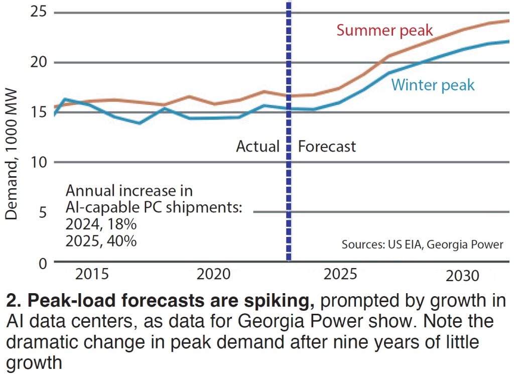

“The AI demand spike on electricity is the single most important fact for you to take home,” Axford said, unless you want to be considered naturally stupid. One utility serving the Atlanta area forecasts its summer peak to rise by 40% in 2030, partly because of AI data center growth (Fig 2).
