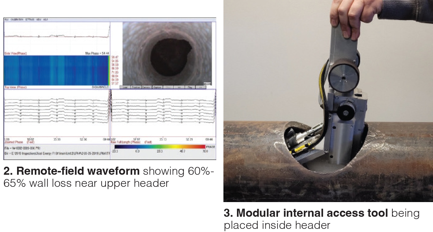

Advanced inspection methods, including robotic waterside inspection of HRSG evaporator and economizer tubes for wall loss, were illustrated with much improved access to tubes. Discussion focused on developing the ability to robotically measure HP evaporator internal tube-deposit density.
One highlight was the Claw for inspecting tube-to-header welds with a balanced-field electromagnetic technique (How to quickly inspect for cracking at tube-to-header welds in HRSG). Equipment size reductions (Mini Claw) are ongoing for expanded header/tube access in more restrictive areas.
In concert with EPRI, TesTex has continued to develop its HRSG internal access tool that inserts a remote field electromagnetic technique probe to inspect HRSG tubes from the inside (Fig 1).
This features a video camera, driver coil, pickup coils, and tail piece. Access is provided by cutting a hole in the HRSG casing and removing the endcap from the header. One example result shown was evidence of FAC and wall loss near the upper header (Fig 2).
A new TesTex modular internal access tool can be inserted through a 203-mm-diam hole cut into the top, bottom, or side of the header (Fig 3). This was first tested in April/May 2024 in an LP evaporator showing FAC in several tubes.

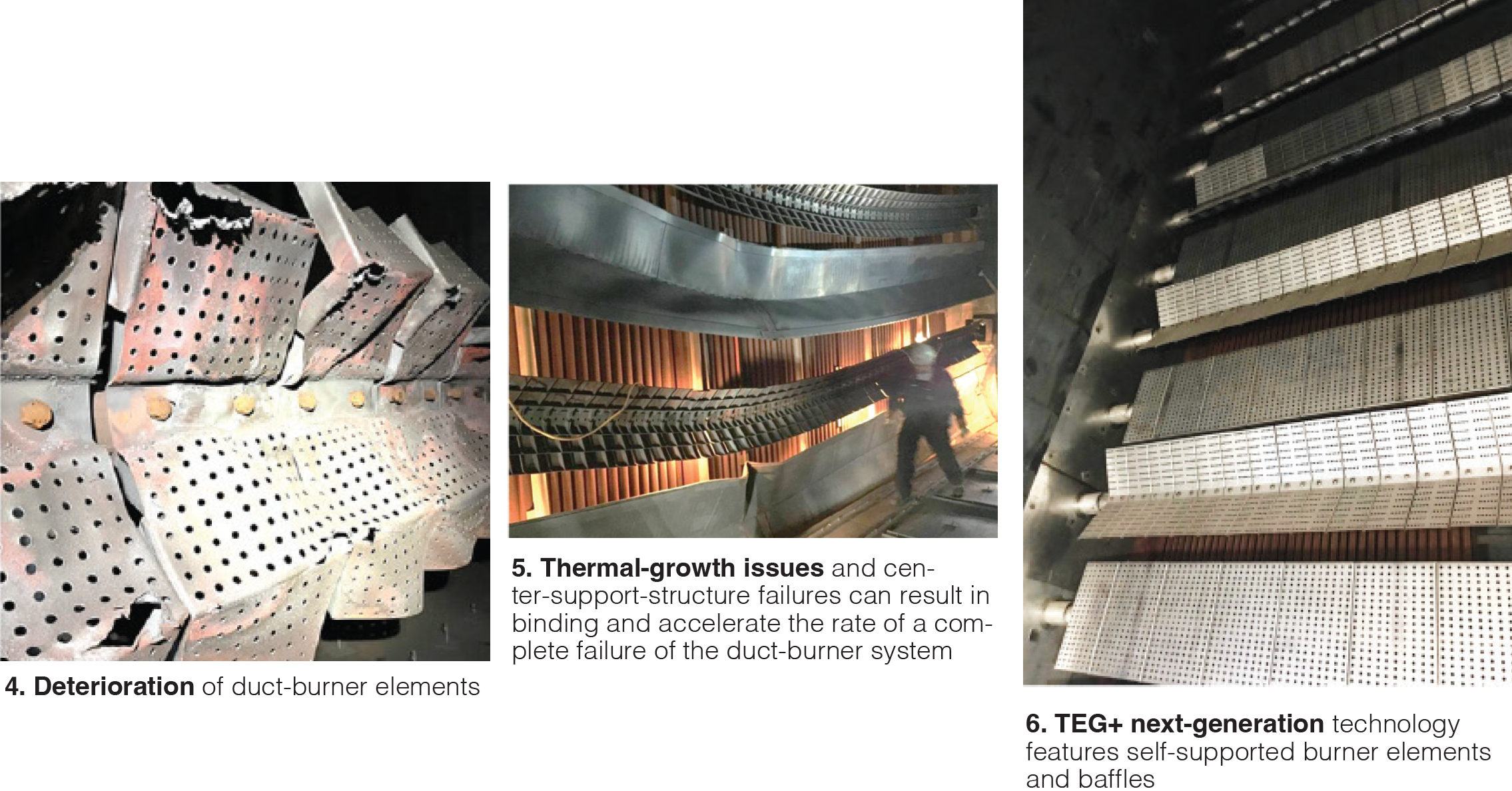

Zeeco Inc, with offices worldwide, has invested in physical modeling along with CFD software to analyze duct-burner systems and solve flow-related issues affecting performance. The basis: Burner performance depends largely on the O2 content and inlet temperature/composition of turbine exhaust gas calling for proper duct length and maintenance. Annual inspections with experienced personnel are critical for long-term, reliable operations.
Zeeco’s Rick Fiorenza explained:
  • Deterioration of burner elements/flame stabilizers can occur (Fig 4). Sagging of burner elements and flow baffles can also occur (Fig 5).
  • Common reasons for upgrading or retrofitting duct-burner systems include GT upgrades, part-load operations, fuel modifications or hydrogen blending, and perhaps new emissions requirements.
  • Modeling has led Zeeco to a “next generation technology” labeled TEG+ shown in Fig 6.

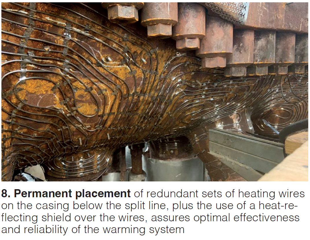

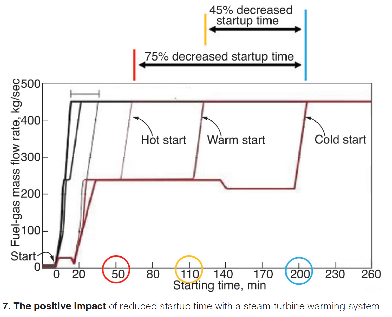

Phil Arnold (ARNOLD Group, Germany) presented a discussion on Advanced steam turbine shell warming system for significant plant startup improvement. This is part of ARNOLD’s comprehensive set of initiatives into HRSG warming, steam-turbine warming, and proper system-wide insulation maintenance.
Arnold’s question: “Why does anyone need a steam turbine warming system?” His answer was shown in graphic form (Fig 7).
Case studies included units by GE (Fig 8), Toshiba, Westinghouse, and Siemens.
Key takeaways included:
  • Reduced startup times by up to 75% (D11 study).
