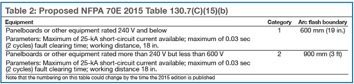

New arc-flash PPE tables [Section 130.7(C)(15)]. The 2015 revision will include several formatting changes to the PPE table (Table 1). The current (2012) table lists both activities that do and do not pose an arc-flash hazard. For example, operating a panelboard is listed, even though it does not pose an arc-flash hazard and, therefore, does not require arc-rated clothing or PPE. These types of activities were included to demonstrate that not all normal activities posed a substantial risk of an arc flash, but some in the industry found it confusing.
In the new configuration, the existing PPE table will be split in two. Table 1 answers only one question: “Is there a significant arc-flash risk?” This table still lists activities that pose a potential arc-flash hazard (working on equipment that show signs of impending failure) and those that do not (non-contact thermography). If no substantial arc-flash risk is present, no further action is mandated by NFPA 70E.
In the revised table, there is no perceived arc-flash hazard as long as the equipment is properly installed, properly maintained, and there is no evidence of impending failure on some of the listed tasks. If an arc-flash hazard is present, Table 2 is used to determine arc-rated clothing and PPE.
Risk must be determined by the user. Determining the risk in performing a task is one of the most difficult, and critical functions in building a risk assessment. The only time electrical equipment poses no risk is when it is in an electrically safe work condition; otherwise, this “residual risk” must be evaluated. Then, it must be determined if the task is safe to perform. For example, if a worker is troubleshooting electrical equipment, it is no longer operating normally; it is in distress and arc-flash protective equipment must be worn to operate it or perform any other task on or with it.
Table 2 for 2015 is very similar to the existing one (limits and categories remain the same), but PPE categories are no longer based on perceived risk. In the 2015 revision, the arc-flash boundaries are rounded up to the nearest foot (except for PPE Category 1) and working distances are the same as in the current table.
PPE Category 1 is still 19 in., because rounding up caused a conflict with the requirement that “all parts of the body inside the Arc Flash Boundary (AFB) must be protected.” If it had been rounded up to 2 ft, the back of the head would probably be within the AFB and workers would have to wear an arc-rated balaclava. This is not the intent of the committee. CCJ
