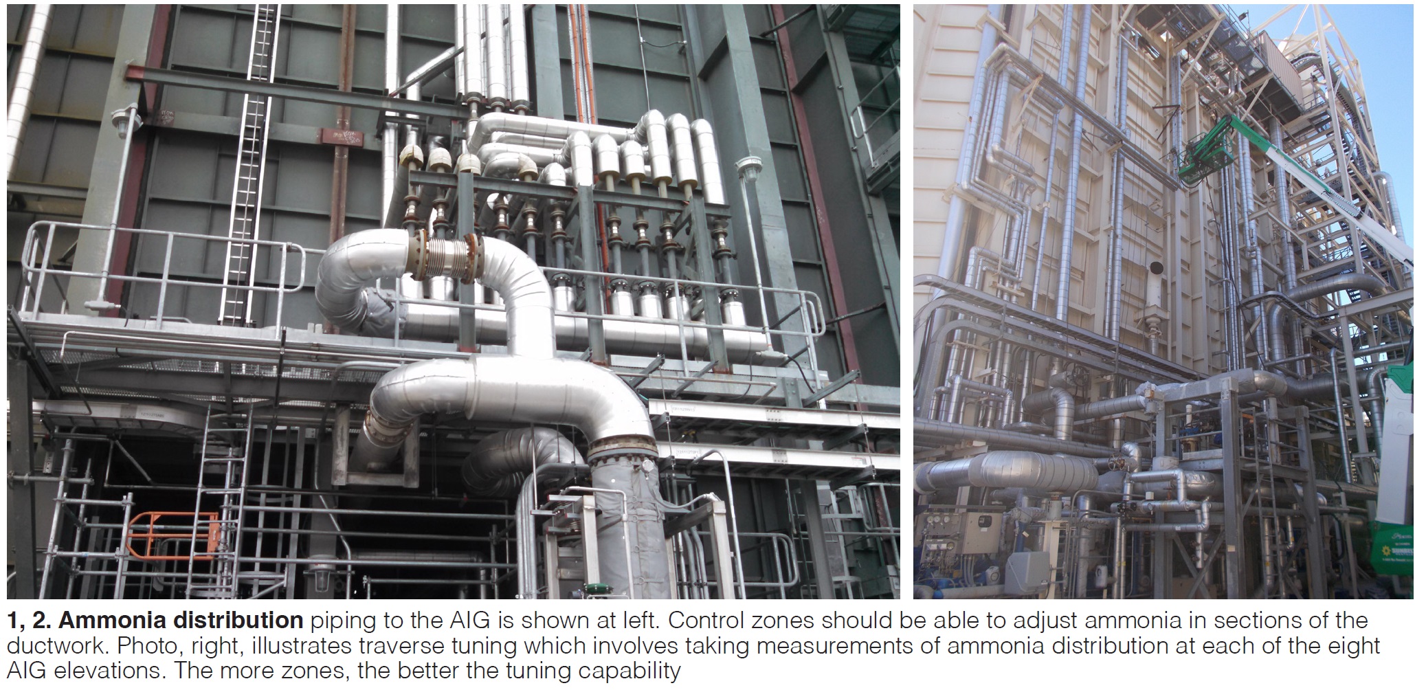

Ammonia distribution within the exhaust gas cross-section is a huge factor in the catalyst’s ability to properly reduce NOₓ levels (Figs 1 and 2). This important part of the system largely falls to the design of the ammonia injection grid (AIG). It must consider both the amount of ammonia and diluent required to inject and mix with the NOₓ present in the exhaust gas.
Careful consideration of injection pressures, mass flow, and density change along the length of each AIG lance are essential for proper distribution and mixing. AIG design for advanced NOₓ control must consider orifice size, spacing, and angle of injection necessary to ensure the proper distribution. This is critical to ensuring the NH₃:NOₓ distribution is matched to the volume of SCR catalyst.
SCR catalyst and the AIG should be inspected during every outage to ensure there is no significant plugging, which can have a major effect on SCR performance by impacting ammonia distribution. Recall that catalyst fouling masks the active pore sites on the catalyst substrate. If you find plugging, eliminate it immediately and determine the root cause. Finally, remember that AIG design can be improved for better distribution and performance, and help provide significant resilience against frequent plugging issues.
