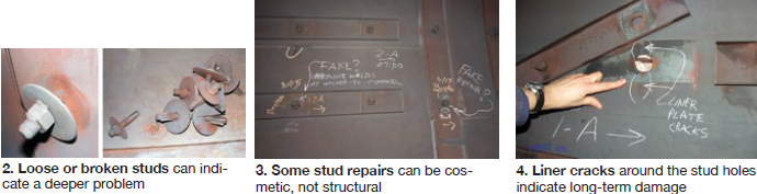

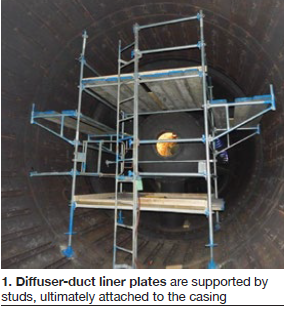

A common 7FA diffuser-duct inspection discovery is loose or broken studs, those components that secure the liner plates and C-channels within the casing. A typical diffuser-duct liner installation can have 1500 to 2000 (or more) studs. Traditionally, these studs are welded to scallop bars, imbedded in insulation, and, in turn, welded to the casing. The studs secure the liners, while allowing them to expand and contract with temperature changes (Fig 1).
The first key indicator of a problem is loose or broken studs, often 10 to 20 or more studs per inspection (Fig 2). Simply fixing the studs can become one of the final tasks during an outage. Crews do what they can with the time available.
As one owner/operator reports, “It starts with a few broken studs, and there’s never a real budget to fix that stuff. You do what you can.”
The result can be improper (incomplete) repair, perhaps more cosmetic than structural. As one field hand puts it, “You’ve got limited time to do 20 studs. So you weld them up and get out of there.” But the loose or broken studs could indicate something much more severe.
Another clear and related damage indicator is liner sheet fatigue cracks propagating from the stud holes (Figs 3 and 4).

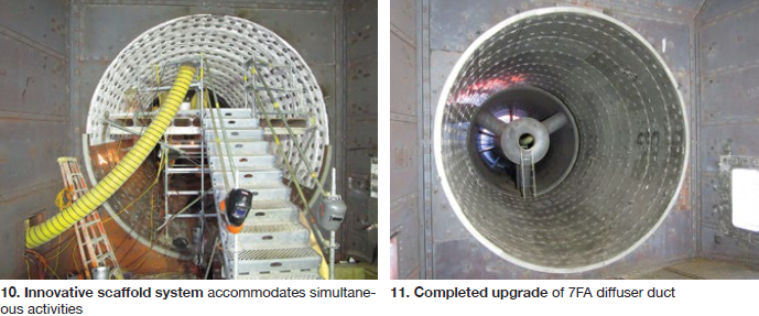

“A lot of the details become even more clear with experience,” reflects Miller “And at our most recent site we had a 28-year-old foreman, sharp as a tack, who wanted to show the world we could do this more efficiently.” The result was an innovative scaffold system that allowed multiple, simultaneous activities (Fig 10).
“They put some outriggers on the interior side of the duct,” explains Miller, “and they outfitted it so we could work on the top and the bottom at the same time. This was huge!”
“It’s like a suspended scaffold,” noted the owner/operator. “You can work top and bottom at the same time, and there’s room to get more people in there than you would think.”
This innovation was used on both Wisconsin units.

And after discussing the latest project (Fig 11), he summed it up: “These jobs are some of the most rewarding due to the final visuals when complete. In that last five minutes before I throw my hard hat in the bag and go home, I’ll stand there, take a few pictures, and think ‘Wow… I had a big part in this.’ And you see the same thing with the contractors, and the site personnel.” CCJ
