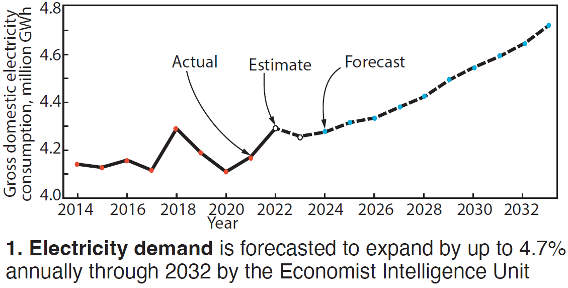

This has changed in the last five years, with the demand for electricity forecasted to expand by more than 4.3% annually over the next eight years (Fig 1). This growth is driven by data centers, cryptocurrency, the expansion of domestic industrialization, and proliferation of electric vehicles. More concisely, the demand for electricity in the form of “final energy” is increasing. By boosting the capacity of existing combined-cycle assets through GT upgrades, companies can increase generation with minimal economical and operational impact.

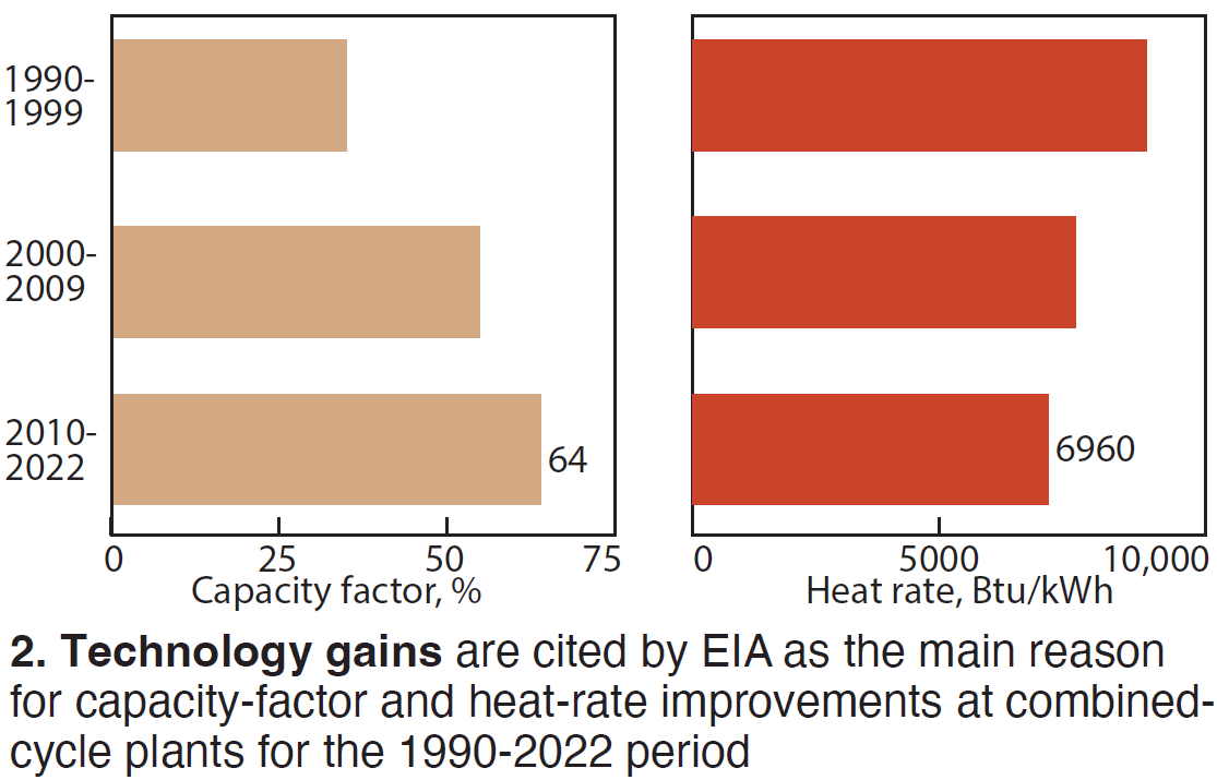

Increasing efficiency. In deregulated merchant states, power producers are burdened with fuel cost and motivated to find ways to maximize efficiency. Turbine upgrades are a good tool for increasing efficiency while boosting output at affordable cost and with minimal impact to operations. As GT efficiencies and heat rates improve, combined-cycle gas-turbine (CCGT) plants can produce more power at less cost. Fig 2 shows capacity factors have risen significantly since 1990, in part through GT upgrades.

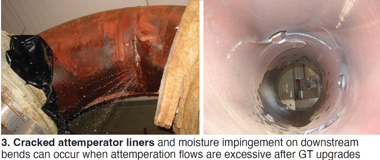

  • The need for attemperation can change significantly if a GT upgrade results in higher exhaust-gas temperatures. Analysis is required to properly size the control valve for the new range of flows. If increased attemperation flow is needed, the type of attemperators in operation (probe versus ring type), as well as downstream straight-length requirements, also must be analyzed to ensure there is no moisture carryover into the downstream superheater tubes (Fig 3).

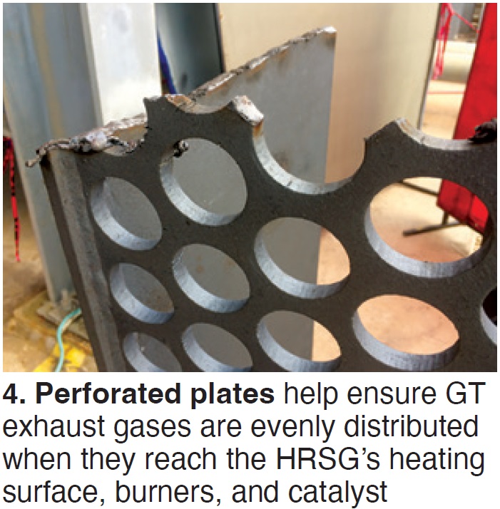

  • Distribution grid (a/k/a perforated plate) helps ensure GT exhaust gases are distributed evenly when they reach the HRSG’s heating surfaces and burners, and catalyst. However, a GT upgrade could change the exhaust-gas profile or flow rates, which can damage the grid (Fig 4).
