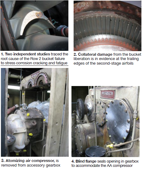

Plant personnel told the editors that the bucket failure was the first major issue suffered by the engine in its lifetime. One reason for the machine’s high reliability, staff believed, is the company’s diligence in operating and maintaining the unit in accordance with OEM guidelines and industry best practices. Example: Lube-oil tests are run monthly to ensure a healthy unit.

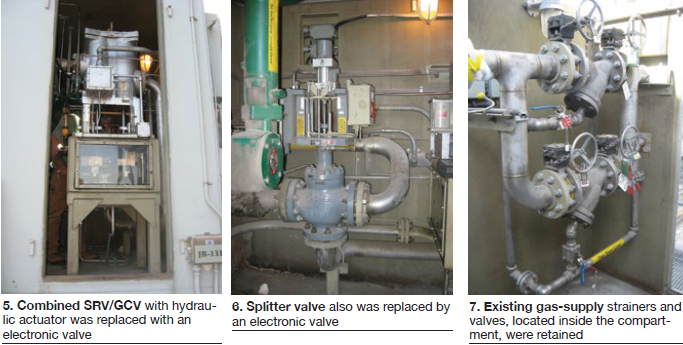

Issues with fuel valves equipped with hydraulic actuators motivated the mill to replace that equipment with electrically actuated valves when the change to gas-only firing was made. A bonus for this upgrade: Less gas is burned to produce a given amount of power than with hydraulic valves in the circuit.
Replacing the mechanical overspeed bolt and trip-oil system with an electronic overspeed trip enables operators to now verify trip functionality at 500 rpm without stressing the unit.

The liquid fuel system (LFS) for this Frame 5 included the following subsystems: primary and secondary liquid fuel and purge, atomizing air, and water injection and purge. LFS decommissioning, a first step in the conversion of the unit to gas-only operation included deactivation or removal of all hardware associated with oil supply as well as of equipment in the subsystems noted.
During the forced outage, key components of the LFS were removed, but because of time constraints and the physical location of some hardware, it was not feasible to remove everything at that time. Others who have performed similar conversions told the editors it’s important to disconnect/remove components that would consume power when inactive—such as the fuel pump and atomizing air compressor—and abandon in place piping that would have no adverse impact on gas-only operation.
The end covers and piping inside the turbine compartment were modified during the outage to reflect elimination of the LFS; Mark V controls software was reconfigured to accommodate the changes made.

  • The accessory-gear-driven fuel pump—together with the electric clutch, coupling, bypass valve, and gear and its bearings. This task complete, a blind flange was installed to seal the pump-drive opening in the gearbox. Note that the liquid-fuel stop valve was not removed, neither was the piping from the stop valve to the fuel pump.
  • The accessory-gear-driven atomizing air compressor—together with its drive gear and associated bearings. This task complete, a blind flange was installed to seal the compressor-drive opening in the gearbox (Figs 3, 4). Note that the atomizing-air filter was not removed but its inlet and outlet piping were blind-flanged.

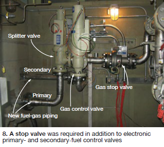

Fuel valve upgrades. The mill’s Frame 5 was equipped with a combined, hydraulically actuated gas stop speed/ratio (SRV) and control valve (GCV, Fig 5) and gas fuel splitter valve (Fig 6). Recall that the SRV and GCV are independent valves. Gas flows through the SRV to the GCV, which regulates the amount of fuel flowing to the ring manifold serving the 10 combustion chambers. The splitter valve serving on DLN machines divides gas flow between the primary and secondary fuel systems.

He added that an increasing number of plants are investigating conversion to electronic valves and most projects can be justified based on opportunity costs. One of the first things to do, Simmons continued, is to determine the availability of physical space to accommodate the new equipment. This shouldn’t be challenging for non-DLN machines, he said.
Some demolition and install of the new valves and electrical conduit/wiring are key elements of the physical project. The editors were told that most wiring generally can be reused; an exception might be that for an old non-DLN unit. Note: Shielded cable is strongly recommended for use with electronic valves.
Finally, if considering electronic fuel valves for your plant, don’t forget to audit the control system logic file to see if it can accommodate the switch from hydraulics to electric. At this mill there was no such issue because so much liquid-fuel infrastructure removed.
TTS modified the gas control software in the Mark V panel and HMI operator screens and then performed functional and operational tests of the new gas control system. Other activities required to complete the project included the following:

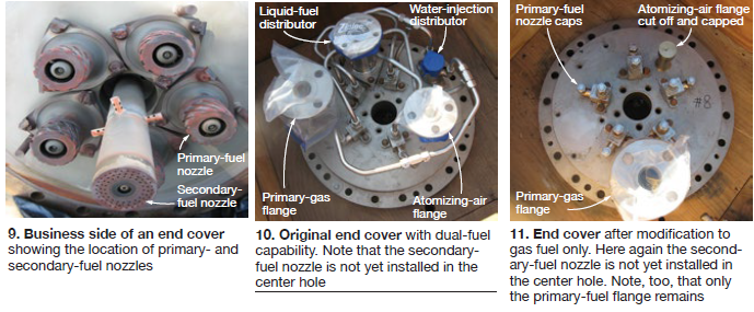

Combustion section. The Frame 5 fuel nozzles were in good condition with only light wear, according to experts. They were sent to a service shop for cleaning, flow testing, and conversion to gas only. At the same time, a set of DLN-1 end covers with refurbished primary fuel nozzles provided by the owner were converted onsite to gas only. The plant’s back-up set of secondary fuel nozzles also was converted to gas. The modified components were installed in the gas turbine (Fig 9).
To convert the dual-fuel end covers to gas only, the liquid-fuel and water-injection distributors were removed (Fig 10 before, Fig 11 after). The tubing runs connecting the distributors to the corresponding five primary-fuel nozzles on each end cover also were removed and caps installed in their place at the openings created. Secondary-fuel nozzles attach to the center of each end cover; their liquid-fuel and water-injection connections also were removed and capped.

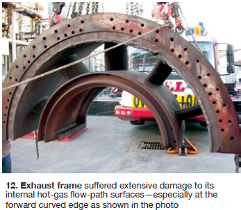

The exhaust frame suffered extensive damage to its internal hot-gas flow-path surfaces—especially at the forward curved edge that exposed the aft strut cooling air to hot gas (Fig 12). The upper and lower halves of the exhaust frame assembly were moved to ACT’s service shop for repairs.
The exhaust frame was blast-cleaned in LaPorte to remove rust and corrosion. New or repaired layers of forward baffle seals were installed by the shop. The damaged second-stage aft wheelspace (discourager) seals also were repaired or replaced. The few cracks found at the support struts were weld-repaired.
