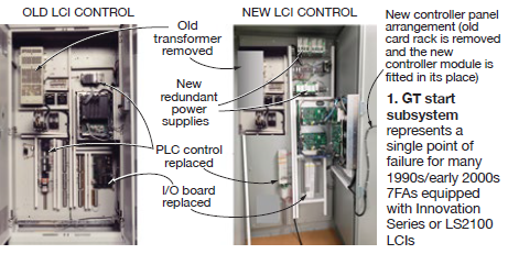

For nearly 25 years, the LCI has provided reliable service. However, with an expected life of 20 years, many have failed, and a substantial number are at, or past, end of life (Fig 1). Failures usually are experienced in the controls and/or the cooling system (Fig 2).

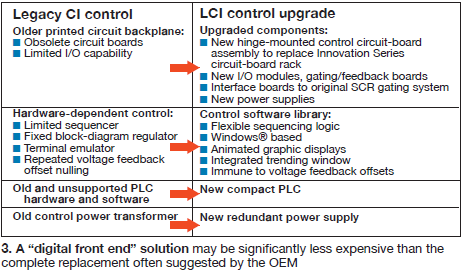

  • Install a “digital front end” (DFE) control section replacement (Fig 3). In this case, the controls are replaced with a modern alternative that extends LCI life by 20 years.
TC&E has partnered with TMEIC, one of the world’s largest manufacturers of LCIs and drives, to provide a turnkey DFE solution that Downing said is far less expensive than the other two options. TC&E/TMEIC also can offer the complete replacement, or additional LCI system, for GE 7FAs and 9FAs. The partnership has more than 15 LCI-experienced field engineers at its disposal.
Guts of the partnership’s offering are as follows: The obsolete programmable logic controller (PLC), standard VME (Versa Module Europa) rack, power supplies, and input/output (I/O) boards are replaced with new processor-based control circuit cards and a new PLC. The new digital controls fit in the existing panels and reuse most of the existing fiber optic cables and connectors.
The upgrade includes a local color touch-screen control panel and HMI interface.
In the control center, the associated software suite expands the programming, control, optimization, troubleshooting, and data logging of onsite operations, engineering, and maintenance personnel. The new LCI DFE utilizes appropriate communications protocol to talk directly to the GE Mark VI and Mark VIe control systems.
The typical upgrade project can be accomplished in five to seven shifts; a turbine shutdown is not necessarily required, although, of course, the LCI will be unavailable for that period.
