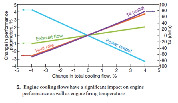

Effect of cooling flows on engine operation. The benefit of monitoring engine cooling flows is better assessment of engine performance and operation. Fig 5 was created using the commercial GasTurb software referenced earlier. An F-Class engine was modeled based on data publicly available. GasTurb uses generic compressor and turbine maps available in the public domain.
The plotted data illustrate the impact of changes in the total engine cooling flow from +4% to -4% on firing temperature, power output, heat rate, and exhaust energy. As mentioned earlier, cooling flows can account for up to about 20% of total engine air flow. The curves were created by keeping the engine on the base-load exhaust-temperature control curve generated by GasTurb and reflect what you would expect to see during operation.
The power and heat-rate impacts are significant from a performance point of view; but just as significant is the impact that firing temperature may have on the lifecycle of turbine parts. Based on experience, increasing the firing temperature by 40 deg F may decrease the life of hot-section parts by as much as 50%. If firing temperature is trended, any spikes or falls in T4 can be identified and investigated immediately. This minimizes the opportunity for surprises that could contribute to unplanned outages or to extensions of planned outages.

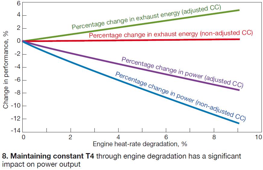

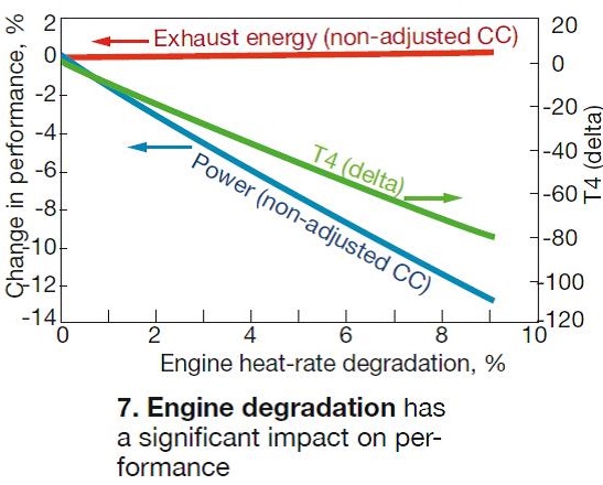

The plot in Fig 8 reflects how engine performance can be optimized by adjusting the base-load control curve, so the engine operates at constant T4. The blue and red curves are the same as in Fig 7. The purple and green curves were developed by keeping the firing temperature at the design level as the engine degrades.
Fig 7 illustrates how a decrease in firing temperature caused by engine degradation adversely impacts performance. This chart was developed by holding the GasTurb model on the design exhaust-temperature control curve. Thus T4 is dropping as engine heat rate increases. Note that the heat-rate increase is based on turbine degradation only; compressor degradation is not included. To reiterate, because the turbine is not able to extract as much work out of the working fluid, the exhaust temperature increases and T4 must drop to stay on the control curve.
In Fig 8, the purple curve represents the unrecoverable and expected engine degradation. The blue line reflects the power loss attributed to both the unrecoverable engine degradation and the inability of the control curve to self-adjust and maintain a constant T4 value.
The bottom-line benefit of monitoring cooling flows and trending firing temperature is that when firing temperature drops, the control curve can be adjusted and some of the lost performance and capacity generally can be restored. The table offers an example, based on the the GasTurb model, of the potential power recovery that a control-curve adjustment can achieve. In this case, 4 MW can be restored 8000 hours after commissioning or following an overhaul. But, once again, remember this assumes heat-rate deterioration is due only to turbine degradation mechanism. If compressor degradation were included, the recovery would be less.
