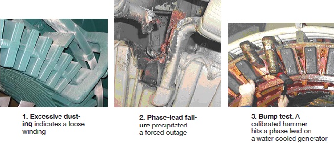

In many cases, loose endwindings have areas of dusting or greasing. Dusting (Fig 1) typically is observed as a white area, caused by insulation-material particles that have abraded away. Greasing is similar: The insulation particles from dusting mix with oil, forming a grease-like substance.
In some cases, visual evidence of high vibration levels cannot be observed. This is often true in the phase leads that join the endwinding series connections to the bus rings. (The phase leads are often a challenge to adequately brace.) Further, because of the many layers of tape, conductor cracking can occur without any outward sign—until a forced outage occurs (Fig 2).

Endwinding bump test
An endwinding bump test uses accelerometers placed on the stator winding, special computer software and computer, and a calibrated impact hammer. The hammer is used to bump the endwinding, causing it to vibrate. The vibrations are then measured and analyzed (Fig 3).
The purpose of performing impact or bump testing on generator endwinding baskets, phase leads, and circuit rings is to identify resonances that would be readily excitable by the electromagnetic forcing frequency (120 Hz in the US).

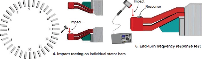

Reciprocity testing is used to determine if the endwinding is well-consolidated and behaving like a monolithic structure. Accelerometers are placed opposite the bump location. As the basket is impacted, the reaction at the opposite location is captured. The impact location and transducer locations are then reversed. This is done at 12:00 and 6:00 and also at 3:00 and 9:00. If responses are similar, the basket is well-consolidated.
Modal testing is performed by measuring the frequency response at selected points on a structure to an excitation force (impact) applied to a single point on the same structure (Fig 4). An alternative is to measure the response at a single point, compared to impacts at various selected points on the structure. The test determines the basket’s natural frequencies and corresponding mode shapes. To perform this test, the following is done:
- Select a minimum of 12 equally spaced points around the circumference of the basket near the end-turn knuckles.
- Radially impact the basket at one of the 12 points and measure the response to the impact at all 12 points.
- Perform modal analysis to determine the basket’s resonant mode shapes and their respective frequencies.
The frequency-response test is performed by measuring and recording the frequency response of an individual end turn or phase lead to an impact applied to that same end turn or phase lead. The test determines the individual end-turn and phase-lead resonances, as well as overall response characteristics (Fig 5). Experts recommend that the test be performed in both the tangential and axial directions.
To perform this test, do the following:
- Mount an accelerometer on the end turn in the knuckle region. For phase leads, mount the accelerometer on the phase lead.
- Radially impact the corresponding end-turn or phase-lead coil in close proximity to the accelerometer.

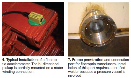

There are several endwinding vibration monitoring systems on the market today. Each is made up of transducers (typically 12 total for the generator—six at each end) and fiberoptic cable that safely transmits the signal from the transducer, through the generator, to the signal conditioner box, and then on to the analyzer (Fig 6).
The fiberoptic accelerometer (FOA) is non-conducting and immune to electromagnetic interference, which is essential in a high-voltage stator winding.
Each FOA transducer must be securely mounted to the end of the stator coil or phase lead in such a way that it can measure vibrations in the radial and tangential directions (Sidebar). The FOAs are attached to individual fiberoptic cables, which are routed to a single frame penetration port at each end of the generator. In hydrogen-cooled units, this port is a welded pressure connection (Fig 7). Since it has to maintain the hydrogen pressure integrity, while allowing the cables to exit the tank, installation of this port requires a certified welder. The cables then run from the connection port to a signal conditioning box, and then on to a programmable monitor.
The monitoring system can measure endwinding vibration during unit operation. If high vibration is detected, load can be reduced, or plans can be made to shut down the unit and perform corrective action to lower the vibration levels. High vibration levels can lead to strand cracking in the stator bars, winding failure, and a forced outage.

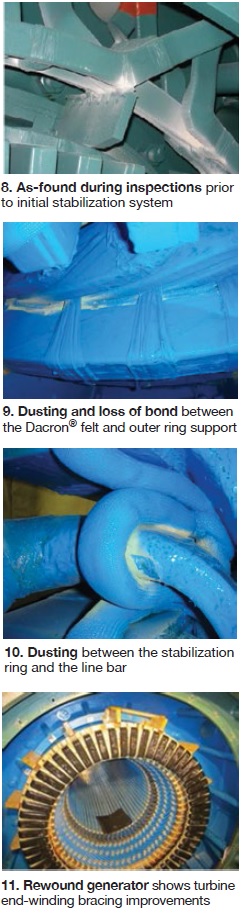

Several attempts to stabilize the endwindings were made by the owner. The first attempt to repair the broken and loose ties was made in October 2007. Additional blocking on the endwindings was also added. However, bump tests confirmed that, while there was improvement in the circuit rings, the endwindings still had a significant response in the operating range of 114 to 126 Hz. Next step: Install an endwinding stabilization system on both ends of the generator during a scheduled four-week outage. The results of a second bump test where within acceptable limits.
However, annual inspections since May 2008 found continual degradation in endwinding supports—as evidenced by dusting.
In 2010, an inspection found dusting between the bar/support ring ties, between the endwinding diamond spacers, between the circuit rings, and circuit-ring ties/blocking. There was a notable increase in dusting in areas with a loss of bonding between the bottom bars, Dacron felt, and the support ring on the outer most support ring. Dusting was even noted between areas of contact with the stabilization ring, which was added in 2007. At this point, it was clear that the endwindings were sufficiently loose that the only cost-effective, long-term solution would be to rewind.
The generator was rewound by NEC during a seven-week outage in April/May 2012. The rewind included a new endwinding support system, which incorporated several modifications to provide better stiffness to the structure.
As part of the rewind scope, a pre-rewind bump test was done to characterize the condition of the stator endwinding. Modal testing indicated that the elliptical (N=2) mode shapes of both the turbine end and exciter end were low-tuned, meaning that the N=2 modes were below the 120-Hz excitation frequency. End-turn response amplitudes were below 0.05 g/lb, with the exception of 12 series connections.
However, the phase-lead responses displayed high amplitudes within the 120-Hz region on the top phase leads 1, 2, 3, 4, and 5 and on bottom phase leads 5 and 6. The bump test results indicated that the support structure of the endwinding was inadequate, and although the endwinding N=2 mode was outside of the exclusion zone, the overall looseness of the winding had to be corrected to avoid a possible shift in resonance.
The unit was rewound with a completely new endwinding bracing system, designed to adequately support the end turns during a transient fault and provide sufficient rigidity to withstand steady-state electromagnetic forces, but still allow the necessary axial differential expansion when the unit comes up to temperature.
Significant improvements to the original endwinding bracing system included the addition of turbine-end braces (no braces existed in the original winding), an increase in the number of braces at the exciter end, tapered blocking at the series connections, additional bus-ring blocking and tying, and an inner nose ring (Fig 11).
After the rewind, a second bump test was completed. The modal testing indicated that the elliptical (N=2) mode shapes of both endwindings remained low-tuned. All end-turn response amplitudes were below the requirement standard of 0.05 g/lb. All phase-lead response testing showed consistent results, with only one bottom phase lead initially being above 0.05 g/lb with a resonance of 0.08 g/lb at 128 Hz. Once blocked and tied, the resonance dropped to 106 Hz, and was well-damped below the 0.05-g/lb criterion.
Results showed clear improvement in the support of the endwindings, which are acting as linear, monolithic structures. Despite all the additional support and blocking, each endwinding was low-tuned with the elliptical (N=2) modes, well below the elliptical forcing frequency at 120 Hz and outside the 115-135-Hz range criteria. Once blocking was added to the bottom phase lead, all phase-lead responses were within tolerance. Additionally, the local response testing showed low amplitudes of response.

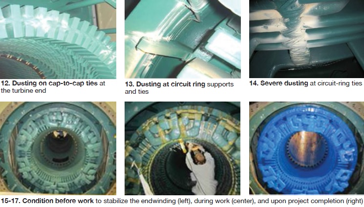

A 301-MVA, 18-kV generator driven by a steam turbine also had issues with dusting, like the unit described above. The machine was manufactured in 2001 and placed in service three years later. Dusting was observed during the first inspection in May 2008 and annually thereafter. Removal of the rotor was planned for October 2011 to fully assess the endwinding condition and to develop a plan for stabilization.
Upon inspection, extensive dusting was found on all circuit-ring blocking and ties, and main/neutral-lead blocking and ties. Circuit-ring taps to the line and neutral bars were poorly braced, resulting in circuit-ring movement transmitted to the stator bars—as indicated by dusting. Extensive dusting also was found on the turbine end of the winding at the bar-to-ring ties to the support rings, and at the series cap blocking and ties. Some of the dusting is shown in Figs 12-14.
Based on these findings and an initial bump test, NEC made several recommendations. First, it was necessary to perform a wedge tap test, replace all loose ties and blocking, install endwinding stabilization rings on both the exciter and turbine ends, re-block, and tie phase and neutral- bar/circuit-ring taps. Also recommended was that a final bump test and modal analysis of the endwindings, connections, and circuit rings be performed to ensure the effectiveness of the stabilization effort. This work was planned and executed over a scheduled nine-week outage (Figs 15-17).
The endwinding stabilization effort improved the dynamics of the endwinding, although not as significantly as in the first case study (above) which involved a rewind. Ongoing monitoring and testing of this unit is planned, but it is clear that the winding life has been significantly prolonged by the repairs. CCJ
