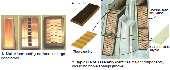

Stator bars for large generators are made in three configurations (Fig 1): At left, “conventional” indirect-cooled; center, “direct-cooled” gas (air or hydrogen); right, “direct-cooled” liquid with hollow strands through which water flows.
The “bare bar,”—that is, consolidated insulated copper strand package, varies among cooling methods and unit size, but the groundwall composition normally is the same for all designs. The groundwall typically is formed by applying mica tape layers to the bare bar. The number of layers depends on the voltage of the winding and the volts/mil the designer chooses.
The composite tape usually is made up of a layer of glass or polyester (Dacron) tape, a layer of mica paper and perhaps a third layer of unwoven material. Total thickness of the tape is around 7 mils. Two bars then are assembled into a slot, as shown in Fig 2. (Very rarely generators have been made with one bar per slot.)
Many manufacturers have not used side springs, although they are becoming more common on large units. A top spring under the wedge is now very common, except on small units.

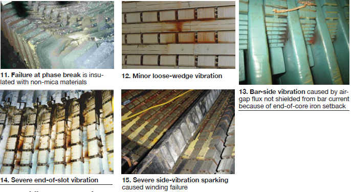

These problems are many and varied and carry low relationship to the groundwall system selected. Some have been experienced by all manufacturers. Some occur on only the VPI systems, some on only the resin-rich systems. Of the problems tabulated in the previous section, a few brief comments:

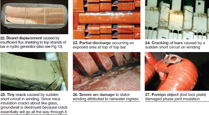

Magnitude of vibrational EMFs. Electromagnetic force is established simply by the design: It is essentially proportional to the armature reaction and inversely proportional to the number of slots. Armature reaction tends to increase with an uprate associated with cooling methods—air or hydrogen—and indirect or direct stator-bar cooling. And how hard the designer is willing to push the duties on the physical components.
Volts/mil. In a laboratory voltage endurance test, a good groundwall will be severely damaged by partial discharge and fail after many hundreds of hours at a stress greater than about 200 V/mil. Most of today’s systems are designed at less than about 70 V/mil and will not fail in 100 years. At 90 V/mil, “good windings” may eventually begin to fail electrically, but not until after many years of service.
Strand insulation. The voltage between strands is very small, but important. At the crossovers it is reinforced by additional insulation. Still, insulation failures occasionally occur (Figs 3-5).
Internal grading systems. These systems can be simply paint applied to the bare bar, but can also be very complex. (The writer it is not certain that internal grading systems are well understood.)
External grounding system. These are always a semi-conducting paint applied directly or via tape carrier. But they are often a troublesome item, primarily on air-cooled generators (Figs 6 and 7). Some experts also are not sure that external grounding systems are well understood.

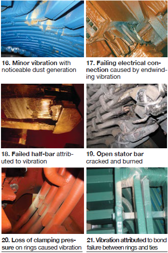

Slot vibration prevention. Slot bar vibration has been a relatively common deterioration and failure mechanism on thermoset windings (Figs 12-15).
Endwinding vibration is a common, widespread, and costly failure mechanism on thermoset windings. It is manifested in many degrees of magnitude (Figs 16-19).
Connection-ring vibration is a common wear and failure mechanism with numerous causes (Figs 20 and 21).
There are numerous other winding duty mechanisms that can cause deterioration and failure. Some are illustrated in Figs 22-27.

Sudden short circuit. Except during synchronizing, the operator will have no control relative to short circuits. If synchronizing is off only a few degrees, no damage is likely. If a short occurs at 120 deg, maximum torque occurs and couplings may slip and other damage may occur. If the angle of synchronizing occurs at 120 deg, maximum forces on the stator winding will occur and the stator winding almost certainly will be destroyed.
