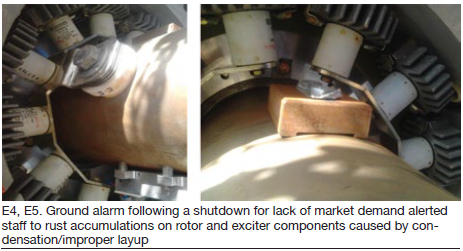

In addition, the following case studies related to improper storage were discussed:
Case No. 1. Unit was in a planned outage (turbine upgrade). During restart after the outage, the unit tripped on stator differential protection. Upon inspection, damage was noted on the turbine-end series loop caps (Fig E3). The failure was attributed to condensation on stator windings.
Case No. 2. Unit was shut down because of grid issues. Upon restart, a field ground alarm was activated and the unit was shut down again. Inspectors noted rust had accumulated on the rotor and exciter components because of condensation and improper layup (Figs E4 and E5).
