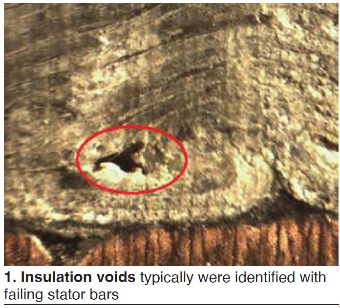

Stator-bar failures traced to insulation voids
A member of the GUG steering committee spoke about his company’s experience regarding premature failures of stator windings attributed to manufacturing issues. Of particular concern was that some failures occurred even after all electrical tests had been passed. Resulting lost production obviously had a negative impact on the bottom line.
Most of the failed bars had voids in their insulation (Fig 1)—typically in the transition/bend area. Speaker reviews the types of tape available and the pros and cons of using each, plus proper taping procedures, electrical testing, etc. Rewind issues at two of the utility’s plants contribute to the learning experience.
“Stator Winding Manufacturing Issues”

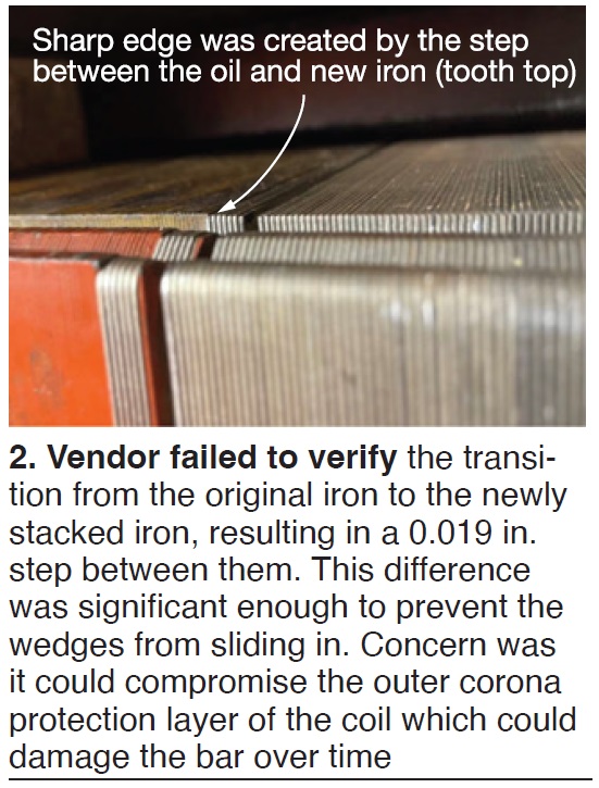

  • Stator rewind lessons learned: winding support-cone findings (misaligned phase-lead banks), step found between new and existing iron after restack (Fig 2), bottom coils damaged during installation, modified wedges to prevent partial blockage of core vents, FME event.
