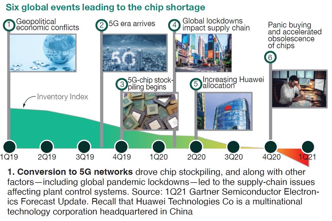

Carrying on the prevalent theme from controls OEMs, Jaime Butler, Nexus Controls (currently part of GE Vernova) included a few valuable slides which help explain the supply-chain disruptions most users are experiencing for chips and other electronic components. The global pandemic was only one of the drivers.
Unfortunately, the conclusion is that, while inventory for unconstrained components will continue to build, products dependent on field programmable gateway arrays (FPGA), power management integrated circuits (PMIC), and microcontroller units (MCU) will continue to struggle. Butler suggests several proactive solutions to mitigate risk.
