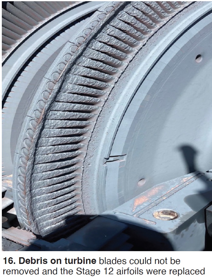

Diaphragm failure takes unit out five months after successful 20-year major
This presentation on a D11 first major outage (20 years in) includes a twist of an ending: While the ST/G major was very successful with a subsequent “exceptional startup,” low vibration, and better than expected performance, four months later site staff observed a loss of approximately 20 MW, elevated reheat pressure, and other maladies. A month later, the unit was shut down to investigate.
Damage to rotor stages 12 to 18 was noted with debris on the blades which could not be removed (Fig 16). Rotor and diaphragms were sent to a shop in Houston, and extensive, surprising (considering the major concluded five months prior) damage to the diaphragms had to be repaired. Root-cause analysis report was being finalized but the direct cause reported was failure of the Inconel 82 partition repair which resulted in the blade damage and restricted the throat area of the turbine.
