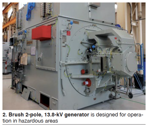

The most popular drivers have been the LM2500 and SGT A35 RB; the generator model supplied for these prime movers typically is the BDAX 71-193 ERH with brushless excitation and rated for 25 to 40 MW depending on site conditions (Fig 2). End-frame stator design allows for quick installation and ease of access for maintenance.
