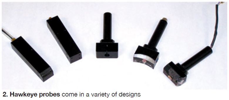

TesTex’s initial use of BFET centered on two types of probes, Hawkeye and Hawkeye DP (deep penetrating). The Hawkeye probe can penetrate up to 0.250 in. into the surface, the Hawkeye DP up to 0.375 in. The probes, traditionally hand-held (Fig 2), are in wide and varied use today. Probe surfaces can be machined to match required geometries (for example, a specific radius for tube and pipe welds), and multiple probes can be rigged for large areas.

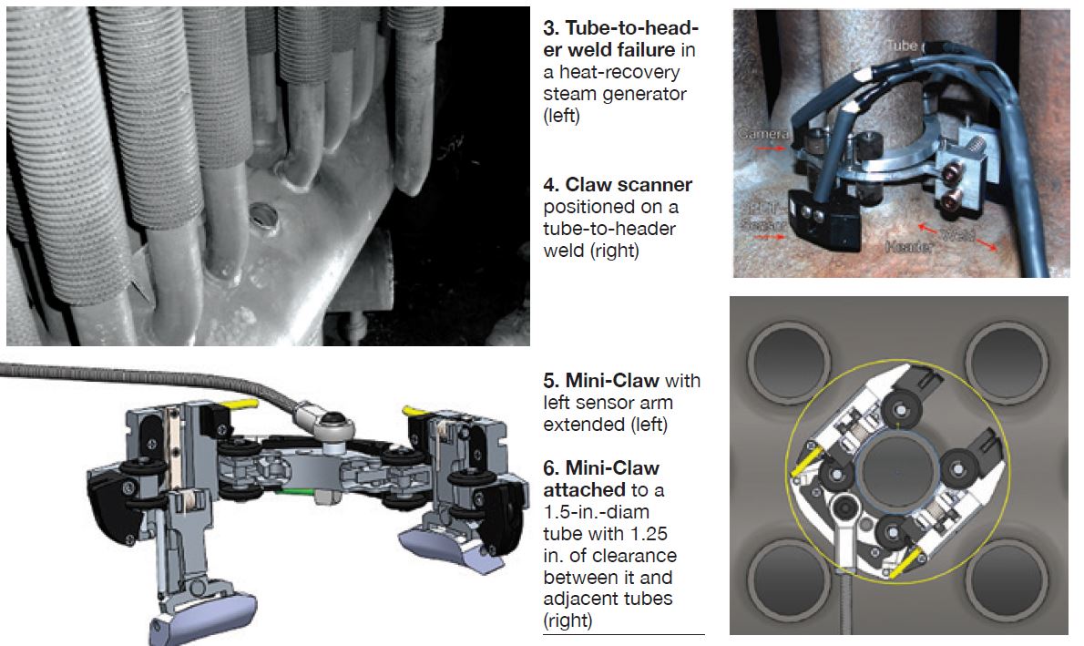

A major issue for both ageing and newer HRSGs is tube-to-header cracking and potential failure (Fig 3), experienced largely through leaks at the tube-side toe of the weld. But this occurs in a very congested, tightly spaced environment. Traditional inspection methods, such as magnetic particle (MT) and others, can only reach the exposed 180 deg—at best.

TesTex developed the BFET, and in collaboration with EPRI, various tools for its application on HRSGs. One of these is the Claw (Fig 4).
With the Claw, BFET probes and cameras are placed on the welds using a C-clamp housing that attaches to the tube. Once attached, the assembly moves circumferentially around the weld examining for cracking, lack of fusion, porosity, and other defects. This technology detects surface cracks, as well as subsurface cracking within 0.250 in. of the surface.

Both the Claw and the new Mini-Claw (Fig 5) can check header welds on tubes with bends above or below the header. The latter is designed specifically for 1.5-in.-diam tubes and with extremely tight clearances between adjacent tubes—down to 1.25 in. (Fig 6). It has now been used successfully on multiple HRSGs.

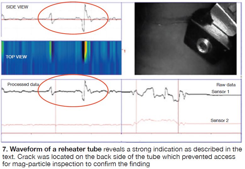

With both the Claw and Mini-Claw, the balanced-field electromagnetic technique waveform is displayed in five different windows (Fig 7). The bottom right window shows the raw data, the bottom left the data processed. The two lines in the bottom two windows show the results from each sensor. The top line is from Sensor1, the bottom line from Sensor 2.
The middle left window is a simulated C-scan, the top left window a zoomed-in view of the data from the second sensor. The top right window shows a capture using the on-board camera.
