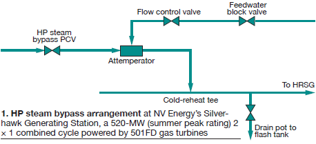

In a typical combined cycle, after the gas turbine is started and the steam begins to absorb energy from the exhaust-gas stream, it flows from the heat-recovery steam generator through the HP piping and is bypassed to the CRH line via the bypass pressure control valves (PCVs), as shown in Fig 1. The HP bypass lines have attemperators on the line to mix feedwater into the bypassed steam and control the temperature of the fluid in the line. Attemperator water flow is controlled using a flow-control valve and a block valve.

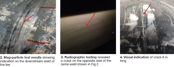

With the unit shut down, insulation was removed in the tee area and a visual inspection was conducted. The downstream weld connecting the tee to the CR piping had a clear indication of a crack, which was confirmed by magnetic-particle and dye-penetrant testing (Fig 2).
The indication was 5 in. long on the pipe OD, 24 in. on the pipe ID. During radiographic testing of the weld after repairs, another crack (Fig 3) was found on the opposite side of the tee in the same weld that had been repaired. This 3-in.-long circumferential crack was repaired as well.
  • March 2016. The CR tee on Unit A failed again on the downstream weld connecting the tee to the steam piping (Fig 4). Availability loss: 26 hours. The crack, confirmed using dye penetrant, was 8 in. long.

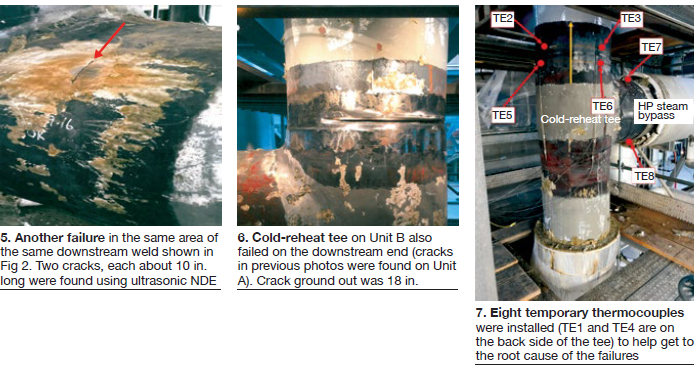

  • September 2016. The CR tee on Unit A experienced its third failure, on the same downstream weld and in the same area as it did in July 2013. Availability loss: 18 hours. Two cracks, each about 10 in. long, were detected during an ultrasonic inspection. A visual indication of one crack is shown in Fig 5.
  • January 2017. The CR tee on Unit B failed at the downstream end; availability loss was 20 hours. The crack, about 18 in. long, was found during an ultrasonic inspection (Fig 6).

Staff suggested two ways condensate might enter the CRH pipe and quench it:
The first, via the drain pot, by back-feeding through the flash tank header, which if unable to drain correctly would allow condensate to pool in the CRH line. This possibility was supported by a report from plant personnel who saw the flash tank overflowing a couple of years prior to this event.
However, backflow was ruled out after review of historian data. There was nothing to suggest the flash tank was overflowing and the drain-pot valve was functioning normally.
The second, via the attemperator and its associated block valve. This could not be verified by historian data because the feedwater flow meter was not working properly.
Engineers then decided to open a drain valve between the flow control valve (FCV) and block valve during normal operating conditions to see of the latter was leaking in the closed position. Water flowing through the drain valve confirmed this was the case. But it was not known if the FCV was leaking as well.
After the CRH tee on Unit B failed early in 2017, insulation was removed and eight thermocouples were installed temporarily on the tee to collect the data required for a true root-cause analysis (Fig 7). Six thermocouples were attached upstream and downstream of the weld, two of them near where the failure had occurred. The remaining two thermocouples were attached on the top and bottom of the HP bypass line connection to the tee.

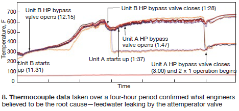

Pipe temperatures were recorded during a Unit B start and when the plant was transitioning from 1 × 1 operation (Unit B gas turbine, its HRSG, and the steamer in service) to 2 × 1 service. Looking at Fig 8, note that as the unit heats up, the temperatures on the pipe slowly increase to 620F.
Now observe that during 1 × 1 operation, when the Unit B HP steam meets the required set point for it to flow through the turbine and the HP bypass valve closes, thermocouples TE7 and TE8 on the bypass side of the tee drop to approximately 300F. This confirms feedwater was leaking through the attemperator valves.
Furthermore, during the transition to 2 × 1 operation (when the Unit A HP bypass valve closes), thermocouples TE1 and TE4, where the failure occurred, drop down to about 360F. This means that during 2 × 1 operation there was a stream of water spraying in the area where the failure occurred, causing the metal to quench and contract.
