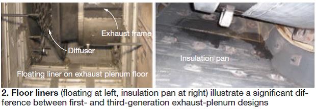

Internal insulation of exhaust ducts improves reliability and lon­gevity by preventing direct exposure of the structural shell to exhaust gas temperatures. The challenge presented by this type of system is designing the insulation barrier to maintain its integrity and effec­tiveness during both base-load and cycling operation.
An internal “floating” liner design meets these requirements. Use of insulation pans (steel plans filled with insulation) does not provide the same level of protection and may actually allow direct exposure of the shell plate to the hot gases.
The floating-liner design consists of metal sheets that are secured, but not fastened, atop insulation compressed to an optimum density between the liner plates and the outer shell plate. Thus the liner is free to expand and contract through­out the various stages of operation.
The compressed insulation used today can withstand very high temper­atures and is tight-fitting to minimize the potential for open spots where the hot gas can contact the outer walls of the ductwork. This is a great improve­ment over the mineral wool formerly used, which would break down and lose its insulating quality over time because of heat and turbulence.
Liner sheets are installed with a “scaled” effect that allows any liquids present within the exhaust to exit via a drain. This reduces the potential for water damage to the insulation and “slumping” of the material, which can cause the insulation to rot and gases to leak by and damage the shell.

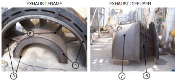

Inspection checklist for frames, diffusers
Before outage
1. Check turbine and load compartment temperatures. Are you able to enter compartments and get close to ductwork? Verify correct temperature ratings for vibration monitors in the load tunnel, which can run between 300F and 400F at base load for GE frames.
2. Verify lube-oil temperature is within manufacturer’s recommended range. High temperature is conducive to varnishing, which should be avoided.
3. Inspect the frame assembly to see if the latest design is installed.
During outage
4. Inspect exhaust-frame flex and “L” seals for cracking and/or leakage. Telltale clue generally is high compartment temperature. Maintain a historical record of these data. Increasing temperature over time typically indicates leakage rate is increasing.
5. Check exhaust-frame strut airfoils for cracking and leakage.
6. Inspect diffuser turning vanes and struts for cracks.
7. Check the diffuser for circumferential cracking.
8. Inspect exhaust frame for flange deformation.
9. Verify instrumentation (exhaust thermocouples, vibration detectors, etc) is in working order.

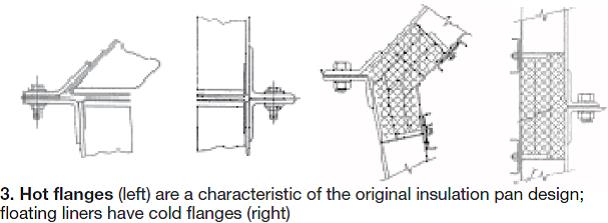

One of the issues with the original pan design was so-called “hot flang­es” (Fig 3, left). Explanation: Ther­mal growth of a pan’s exposed sur­faces does not match that of the outer perimeter, thereby causing distortion along that perimeter. Gaps occur between pans, allowing hot exhaust to contact the outer shell; distortion and cracking result.Two major benefits the third-generation exhaust system has over the origi­nal are (1) floating floor liners described earlier and (2) cold flanges. Fig 2 shows the floating liner for the exhaust plenum floor at the left; photo at right is of a first-genera­tion insulation pan in the same location.
Floating liners have “cold flanges” (Fig 3, right), which are character­ized by field-installed wrapped insu­lation pillows and liner plates. This design creates a continuously sealed thermal insulation barrier conducive to a cooler interface.

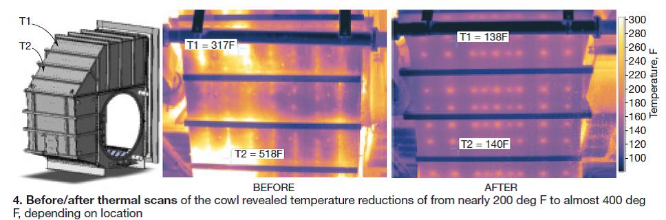

Result of the upgrade was a dramatic reduction in the external temperature of exhaust system com­ponents. “Even before the thermog­raphy survey was performed on the first unit upgraded,” Project Man­ager Daryl Whitfield said, “it was evi­dent that its plenum was much cool­er than those for the other machines.”
A thermographic survey showed just how much cool­er the new third-generation exhaust system was compared to the original. For example, before/after thermal scans of the cowl revealed tempera­ture reductions of from near­ly 200 deg F to almost 400 deg F, depending on mea­surement location (Fig 4). Average temperature of the expansion joint between the plenum and the HRSG decreased from just under 500F to slightly more than 200F (Fig 5).

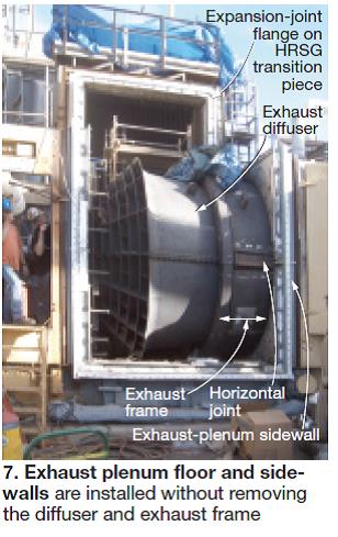

Allow for adequate cooling of the exhaust system—one to two days after removing the gas turbine from service. Do final parts inven­tory and other soft tasks dur­ing this time. Be sure to acquire all new bolts/hardware and flex seals. These should be included in the field kit supplied by the ple­num manufacturer.How the job was done. Plenum replacement is not difficult if you take the time to properly plan and exe­cute the project, and use experienced resources (Fig 6). Here’s a summary of the procedure used at Altura Cogen:
  • Unbolt the wing and cowl from the plenum. Then unbolt the upper walls and cut out the lower half of the plenum. Important to note is that the diffuser and exhaust frame need not be removed to change-out the plenum.
  • Cut the expansion joint connect­ing the plenum to the HRSG. Note that the expansion joint is bolted to the plenum side and welded on the other side to a flange on the HRSG. Next step typically is to clean, dress, and true-up the boiler flange. This can be time-consum­ing and challenging because metal moves and distorts over the years.
  • Clean up the interfaces with the gas turbine as well.
  • Install the new expansion joint and then the lower half of the ple­num. Next, put the upper walls of the plenum in place and true-up the work before installing flex seals. Progress to this point is shown in Fig 7.
  • Next the wing and cowl are replaced (Fig 8).
  • Finally, insulation and liner are installed internal to the plenum at the joints. And the floating liner is bolted into the HRSG liner system.

The entire project was completed over 12 one-shift days. This means it’s possible to replace an exhaust plenum assembly for a Frame 7 engine during an extended combus­tion inspection, as well as during hot-gas-path and major inspections. ccj
