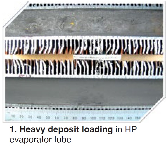

In December 2016, the station incurred several HP-evaporator tube failures in two of its seven HRSGs. All experienced under-deposit corrosion. Failure analysis indicated significant amounts of deposit weight density (DWD) within the tubes. The first sample showed the loading at 154 g/ft2.
In 2018, borescope inspections at Unit 2 showed a concentration of debris within the front headers and within the tube bundles approximately 18 to 20 in. above the bottom header. Tube leak-location experience was then analyzed. Tubes were removed (Fig 1) showing heavy deposit loading and wall-thickness issues.

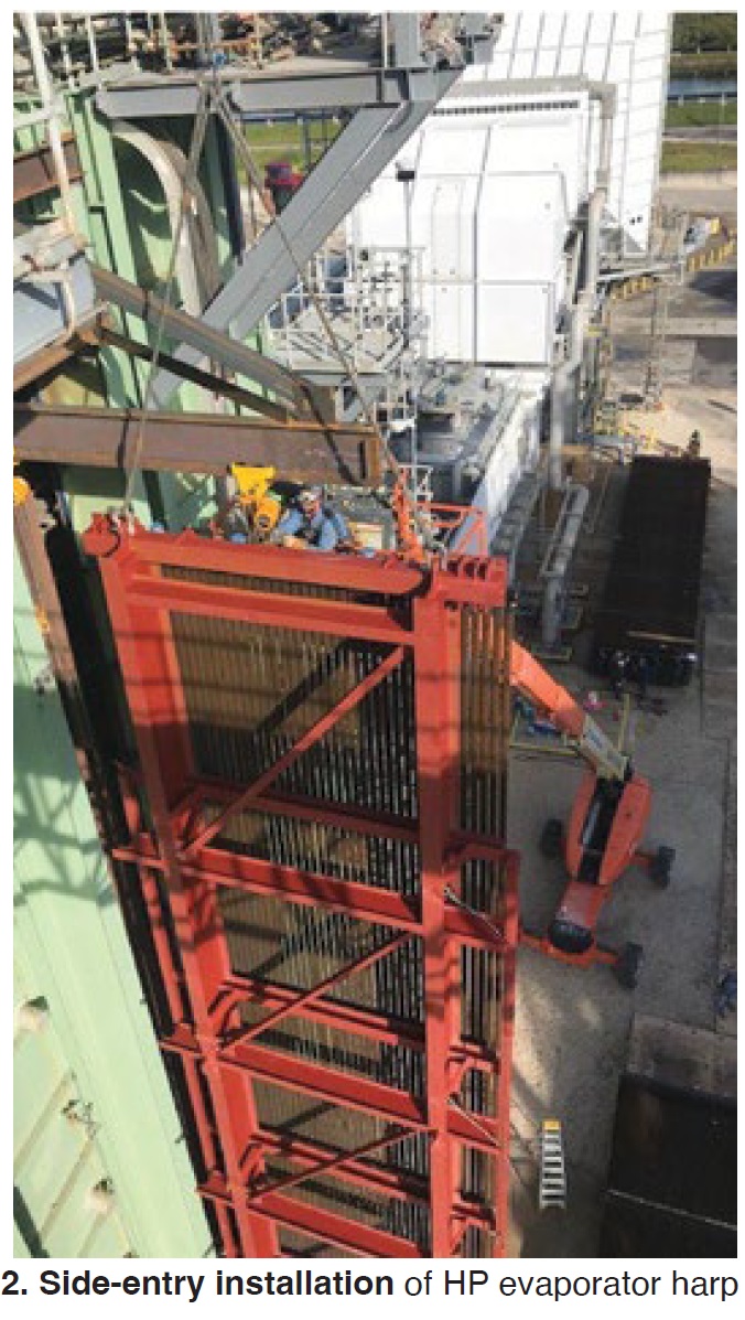

Preliminary construction planning considered both side and top access. Top entry was not effective because of the drums, so TECO selected the individual-lift side-entry option. The power producer also selected in-shop hydro with authorized inspection to ensure the integrity of welds and conduct any repairs before delivery.
“Demolition was one of the most challenging parts of the construction phase,” explained Bala. Harps were severed and removed.
“Coordination within the last 100 ft is critical; new harps must be delivered in the proper sequence!”
Installation included 48 individual harp lifts using one handling frame and one up-righting frame. A monorail system was used to slide the harps into the HRSG (Fig 2). Welding and NDE followed.

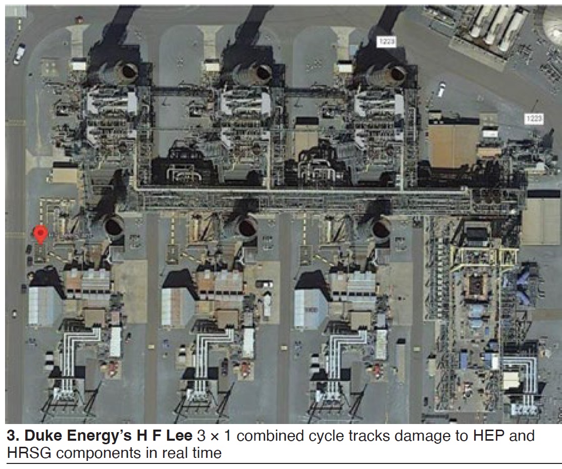

Duke Energy and Structural Integrity Associates (SI) jointly discussed online monitoring—more specifically a unique HRSG damage monitoring system. Presenters Eugene Eagle (Duke) and Kane Riggenbach (SI) looked at real-time assessment of system performance and component integrity for both HRSGs and high-energy piping.
Their example: Duke’s 920-MW H F Lee Energy Complex, a 3 × 1 combined cycle (commercial 2012) anticipating future cycling requirements (Fig 3).
The Siemens F-class gas turbine/Vogt triple-pressure HRSG units at Lee have accumulated nearly 70,000 hours and have had damage issues related to RH and HP attemperation. “Many SH/RH drain, operational, CT exhaust, and attemperator control logic changes have been implemented,” explained Eagle. Current operation is baseload, with low-load turndown to 40 MW per gas turbine.
They began with an interesting HRSG overview, adding that each unit has surface-mounted, thermocouples of an advanced design that were installed at commissioning. It showed components typically susceptible to creep, fatigue, creep-fatigue interaction, corrosion fatigue, oxidation, and exfoliation. The focus (16 areas per unit) includes interstage and bypass attemperators, intermediate headers and tubing downstream of attemperators, branch connections, final-stage outlet headers, and drums.

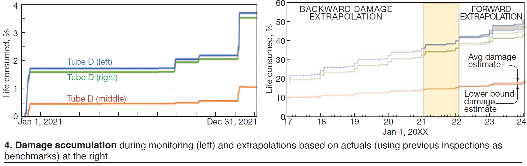

Structural Integrity provided and monitors the PlantTrack™ system installed after 70,000 service hours.
Program goals are early detection when rate of damage is rising, and prioritizing locations and systems with a long-term goal of extending inspection intervals. Data can also be used to assess accuracy of fitness-for-service assumptions and adjust recommendations.
Specific life-management benefits include detection of operational or process changes (failed nozzles, leaking valves, etc) and evaluations of control logic changes (valve opening, spray amounts, etc). Comparison of operating modes (and impacts on component life) are made between units and plants, for low-load operations, operating with and without steam sparging, and for changes in startup times.
Riggenbach explained damage trending saying that “when monitoring, a time series of damage will be created,” then adding that “a historical rate of damage consumption can be extrapolated.” Previous inspections can be used as benchmarks. With this, future projections of damage consumption can be made (Fig 4).
Various examples of data presented on the PlantTrack Dashboard also were provided.
Duke’s plan is to develop trends and translate the data for sister units.

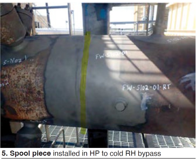

Al Olszewski, Constellation Energy, reviewed fleet-wide Attemperator inspections and repairs. This non-plant-specific presentation covered selected issues with various attemperators, including:
- High-pressure (HP) to cold-reheat bypass. Fig 5 shows internal indications at downstream girth-weld (P91 material). Girth weld was machined out and repaired with spool piece.

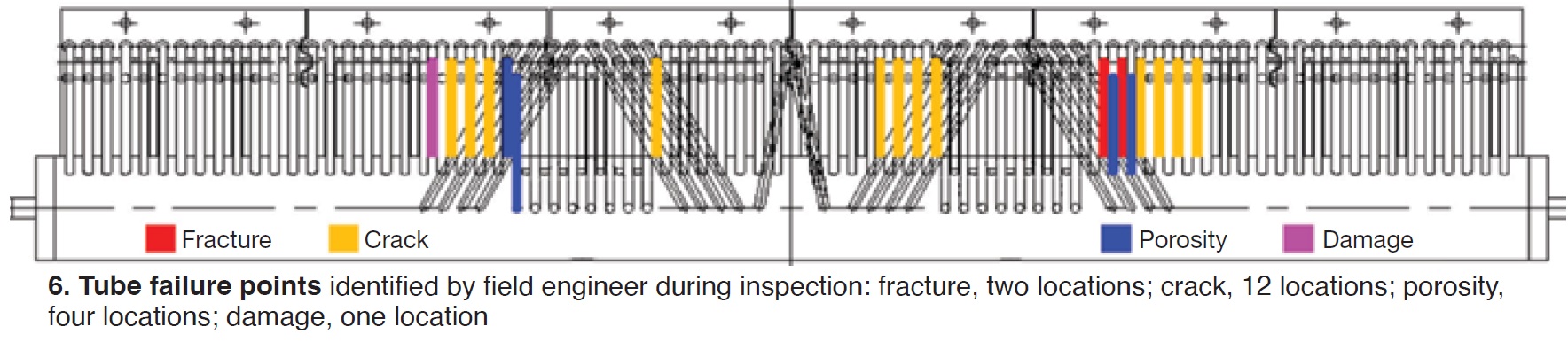

Ghazi Al-Shammari discussed HRSG tube failures and consequences. He walked through the plant’s background, then focused on the tube failures in one unit that became apparent in 2016 (high water consumption, noise, and steam emitted from the main stack).
All tubes and headers were visually inspected. Tube defects were found at 19 locations near the hot-reheat header. Thermal-fatigue cracking also was apparent close to the tube-to-header welds (Fig 6).
The speaker walked through the various damage mechanisms found and then the root-cause graphic depiction of thermal stresses.
Recommendations made based on plant experience were these:
- After each HRSG shutdown, ensure all TCVs/bypass MOVs and inlet isolation MOVs are closed.
- Follow normal startup procedures and physically verify all valve positions, both open and closed.
- Watch for any abnormal valve behavior—including noise, vibration, or temperature change.
- All manual drain isolation valves should be open at all times.
- All drain MOVs should be on auto at all times.
- Operators should physically monitor drain-valve levels and differential temperatures at all times.
Qurayyah has reduced (1) annual forced outages attributed to tube leaks from five to one, (2) water consumption, and (3) tube metal temperatures.

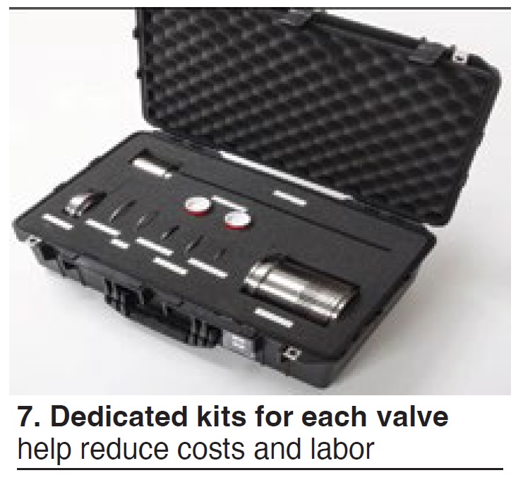

Athens uses Millenium’s TrimKit™ program to reduce costs and labor, and to provide all new parts for specific valves. Refurbished parts can be returned to the kits (Fig 7).

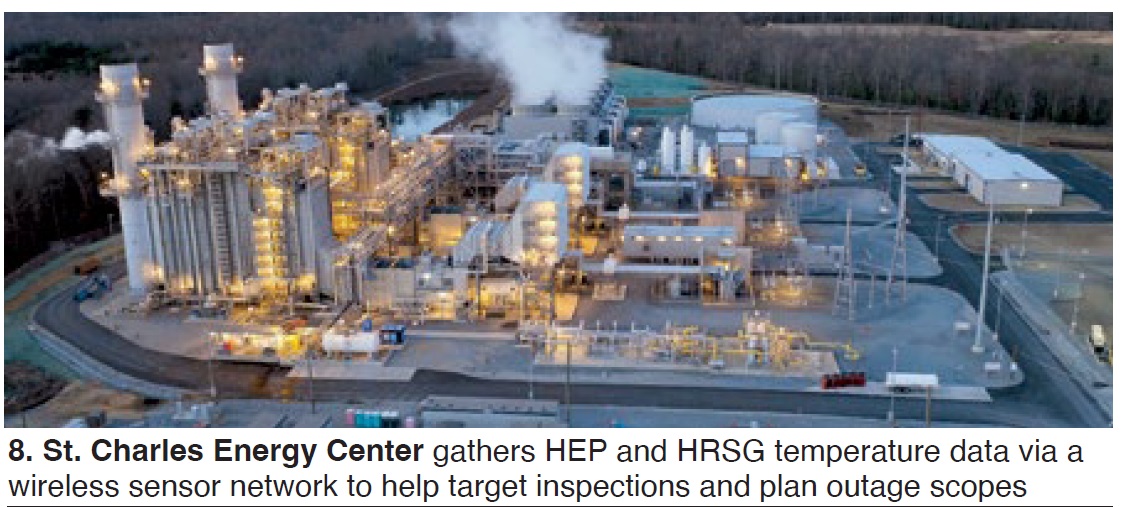

CPV’s St. Charles Energy Center in Maryland (Fig 8) has implemented a wireless high-energy-piping (HEP) program, which was described by Jacob Boyd. Background: The 745-MW plant, commissioned seven years ago with two GE Fast-Start 7FA.05 gas turbines, one GE D-11A steam turbine, and two CMI HRSGs, typically cycles from 140 to 170 times annually.
Near the end of 2019, one HRSG suffered a through-wall leak at a girth weld on a hot reheat (HRH) steam-to-condenser bypass line. The failed weld was removed and sent to Structural Integrity (SI), finding that thermal fatigue was the most likely cause.
“Plant personnel worked with SI to install thermocouples around the area to assess the magnitude of thermal transients during load changes and normal operations,” explained Boyd. Significant temperature variations around the pipe circumference (up to 700 deg F) were noted during load-change events. SI data were sent to the OEM who redesigned the HRH bypass attemperator spray-nozzle assembly. Plant staff modified the attemperator logic.
The plant had only been operational for two years, and “plant staff was concerned there may be other unknown high-energy piping issues that could fail prior to regularly scheduled inspection,” said Boyd. “Working with Structural Integrity, a solution was proposed to install a wireless sensor network and thermocouples to remotely read data in near real-time and incorporate the readings into St. Charles’ PlantTrack online database.”
SI performed a risk-ranking prioritization known as Vindex™ (Vulnerability Index) that considers factors such as creep life, Grade 91 risk factors, consequence of failures, etc, and assesses each weld or location of interest according to damage potential. The plant then installed thermocouples at 10 different locations throughout the HEP system, plus nine online pipe-hanger monitors.
Data were used for the spring 2023 outage. Online monitoring of the HRH bypass had shown five high events and 155 medium events. Field results in 2023 then identified multiple ID and OD indications. A spool piece was needed and installed.
Said Boyd, “the system is a highly valuable tool to target inspections and plan outage scopes. We now have improved plant safety and reliability, while reducing O&M costs and the potential for lost generation.”
