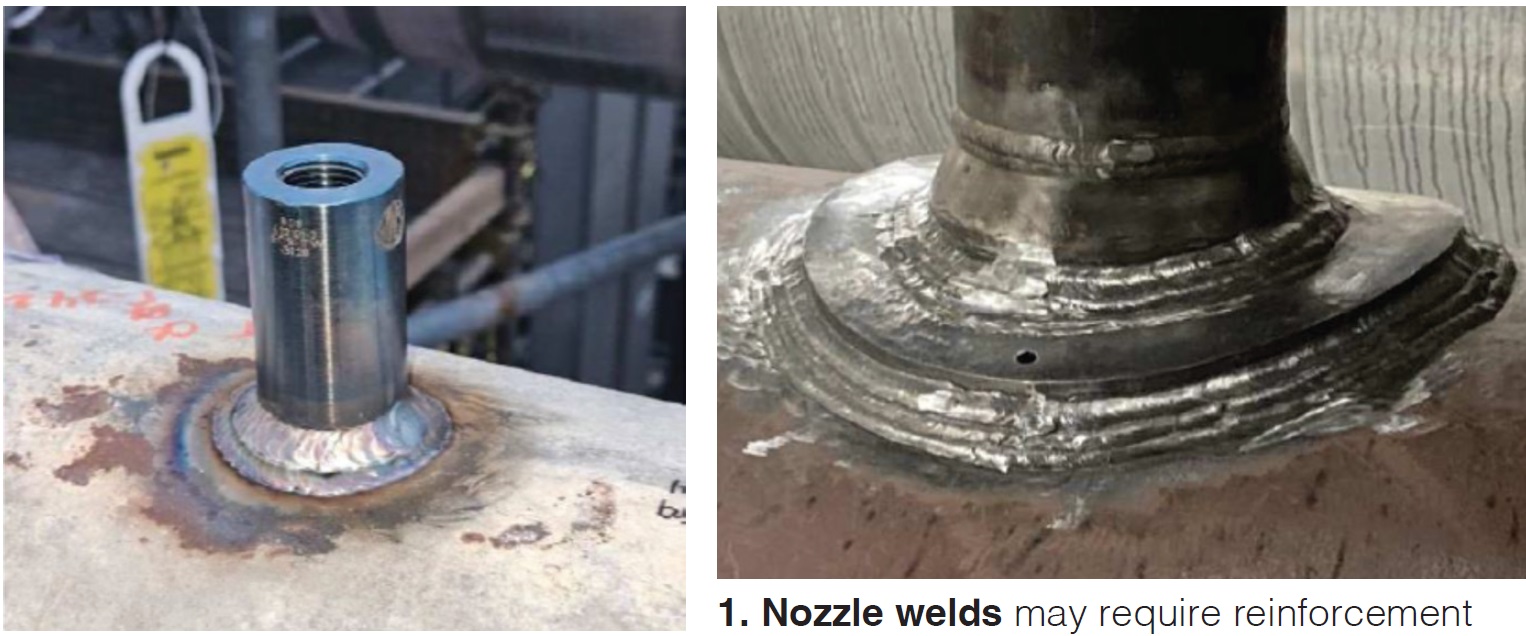

Keep in mind that major pressure parts sometimes pass the mechanical calculations but attachment welds do not. For example, in a recent re-rate by Vogt Power, the drum shell and head passed Code calculations under the new pressures, but the nozzle welds did not and required reinforcement weld pads (Fig 1).

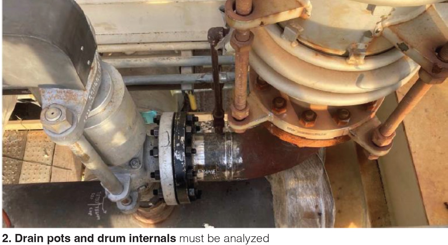

Miscellaneous components. Following current codes instead of legacy codes when re-rating systems has broader impacts. For example, plants built in the early 2000s, and earlier, typically had a 2-in. drain pot downstream of the attemperator spray piping.
However, the latest pressurized (P) HRSG Code requires drain pots to be one nominal pipe size smaller than the piping they are installed in, up to a drain-pot size of 12 in. Therefore, if the HP steam or RH systems are being re-rated, new and larger drain pots must be installed to comply with PHRSG requirements.
Additionally, the safety valves of the re-rated systems must be replaced or have their springs reset to match the new system pressure. Capacity of the safety valves also must be considered because higher steam flows dictated the re-rate.
Similarly, the steam separation capacity of the drum internals must be verified to ensure there is no increased risk of moisture carryover from the drums (Fig 2).
