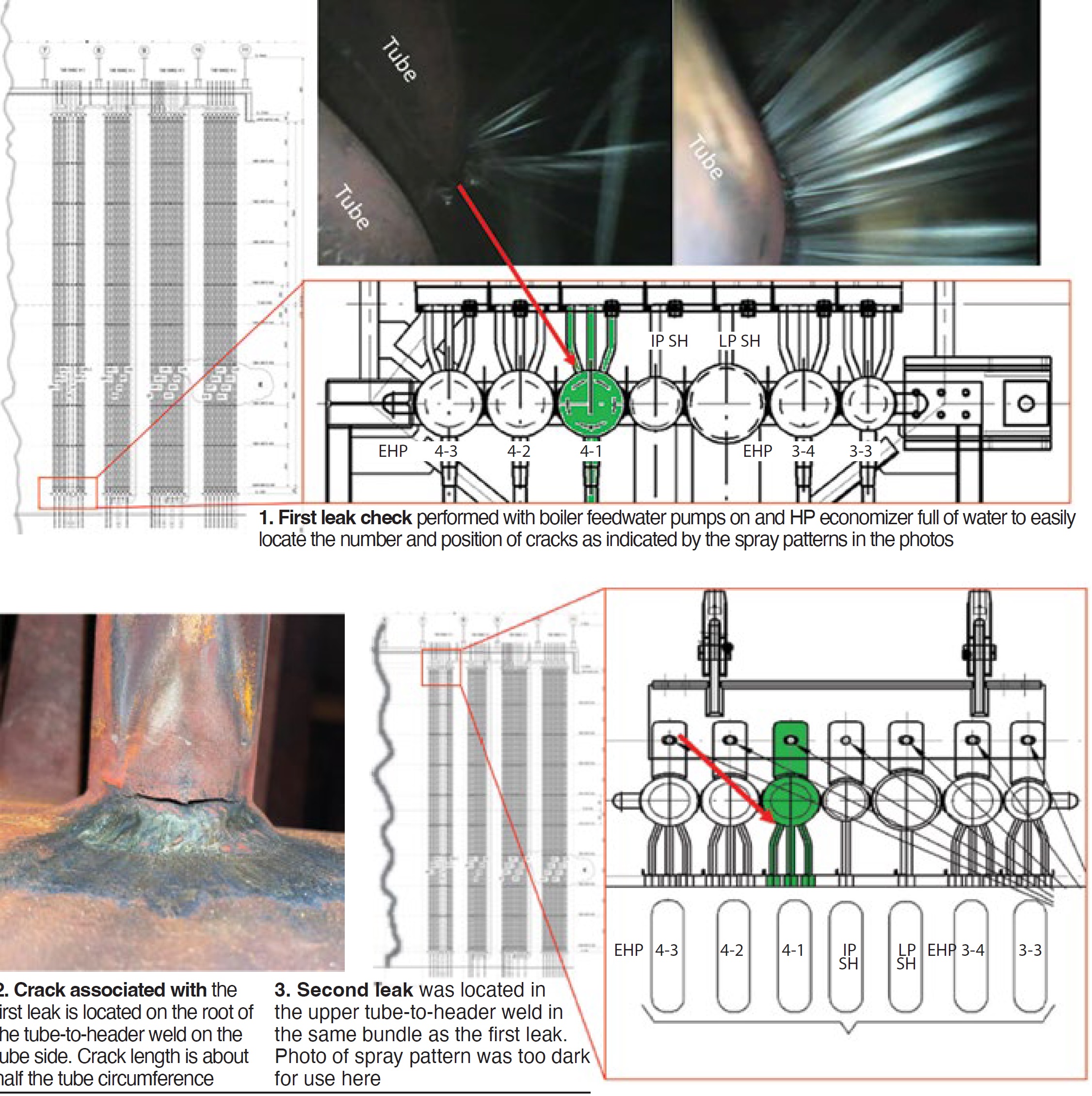

The first leak was identified by water droplets found under an HP evaporator tube bundle during operator rounds in January 2023. Makeup flow increased dramatically over the next month or so to more than 15 gpm. The unit was shut down and a gas-side inspection conducted with feedwater pumps operating and the HP economizer full of water (Fig 1). Access to the crack (Fig 2) in a lower tube-to-header weld, and its repair, were challenging, as Grognet describes in his paper. The unit was restarted without incident.
The second leak was found 3000 factored fired hours later in the same tube bundle, but this time in an upper tube-to-header weld (Fig 3). Access for repair was much more difficult here than in the first case. Typical solutions—(1) cut your way in, make the repair, and weld your way out, or (2) cut an access port in the header, plug the leaking tube, and restore the integrity of the header—were rejected in favor of cutting free EHP 4-3 and 4-2 and lowering those bundles to provide the necessary access. You’ll want to read about how this was done.
A root cause analysis determined thermal fatigue was the primary cause of the failures, as explained in the paper.
