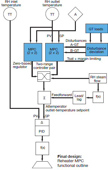

Following extensive testing, the MPC design was selected for deployment at the plant. The design was installed and commissioned on one HRSG reheater temperature control loop. This arrangement enabled a comparison between the performance of the MPC (A-HRSG controls) and the original PID (B-HRSG controls).
A control switching facility also enabled a comparison to be made between a retuned PID control and the new MPC design on the same HRSG. Wide-range load-ramp tuning and benchmark tests were performed, providing data for a quantitative performance comparison.

The MPC facility’s capability to input two independent disturbance variables inputs was used to advantage on the reheater to reject the disturbance caused by load changes on both the A and B gas turbines (GTs). The SH outlet and disturbance response models vary significantly over the GT load range. Because the MPC is not adaptive, two MPCs were used with a fuzzy blending (weighted average) function to slide between controllers, which were sufficient to cover the entire load range.
For the MPC design to provide significantly superior performance during load ramps, the structure must include an output feedforward signal predicting the expected attemperator outlet temperature. The MPC design, as implemented for the tests, provided significant improvement to temperature disturbance deviations, time to settle, periods away from setpoint, and overall stability. The final design for the reheater MPC functional outline is shown in the figure.
