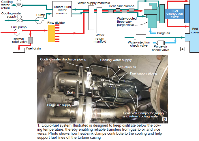

Until recently, owner/operators upgrading to active cooling were required to run on liquid fuel at least once a month to maintain system reliability. But the integration of JASC’s heat-sink clamp into the fuel-supply system eliminates the need for monthly test runs at considerable saving in operating expenses. The drawing in Fig 1 illustrates where the water-cooled heat-sink clamp is installed and the photo shows how it supports fuel piping off the hot casing.
Note that the three-way purge valve in Fig 1 is water-cooled, which is critical for preventing coke formation. This is important for achieving valve refurbishment intervals of 24,000 to 32,000 hours consistent with industry norms for hot-gas-path inspections.
The current maintenance interval for uncooled or fuel-cooled three-way purge valves is annual and not related to operating hours. Water cooling can be added during refurbishment of uncooled valves with bolt-on hardware. Existing turbine purge air, liquid fuel, instrument-air piping, and valve flange connections remain the same, making the conversion economical for the benefits gained.

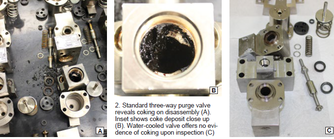

Fig 2 shows the coke buildup you can expect in the fuel inlet of an uncooled valve after several months of gas operation versus the “like-new” condition of a water-cooled valve recently overhauled. The latter illustrates the effectiveness of water cooling on the first 7FA equipped with both the three-way purge valve shown in Fig 2 and heat-sink clamps.
The unit operated on liquid fuel after every 25 runs on natural gas during the 2017 summer season and exclusively on liquid fuel during the winter. Based on the coke-free condition of the valves inspected, JASC has advised the turbine owner to operate on liquid fuel after every 50 runs on natural gas during the 2018 summer season.
