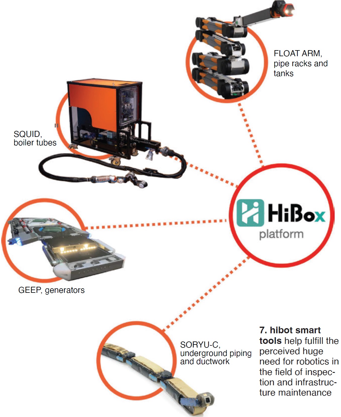

Snake or calamari? Paulo Debenest, hibot, Japan, explained that for 20 years, he and others have been working with robotic solutions to make inspection missions safer, faster, and more reliable. Note that hibot is a startup operation with roots in the Tokyo Institute of Technology.
Debenest’s presentation: Robotics applied to inspection of infrastructure: Examples of internal and external pipe inspection. “These are not human-like robots. They are smart tools” (Fig 7). “They might be ugly, but they are all very functional,” he said.
The snake-like unit shown in Fig 8 is a float-arm concept driven by air. And where the head goes (Fig 9), the rest will follow, able to overcome obstacles in crowded environments, he explained. Another, labeled the squid and specifically for boilers, is driven by water (Fig 10).
This presentation focused on pipe inspections in boilers, heat exchangers, and pipelines. Specific to HRSGs this applies to pipe inspection inside (boiler and cooling water pipes) and outside (pipe racks).

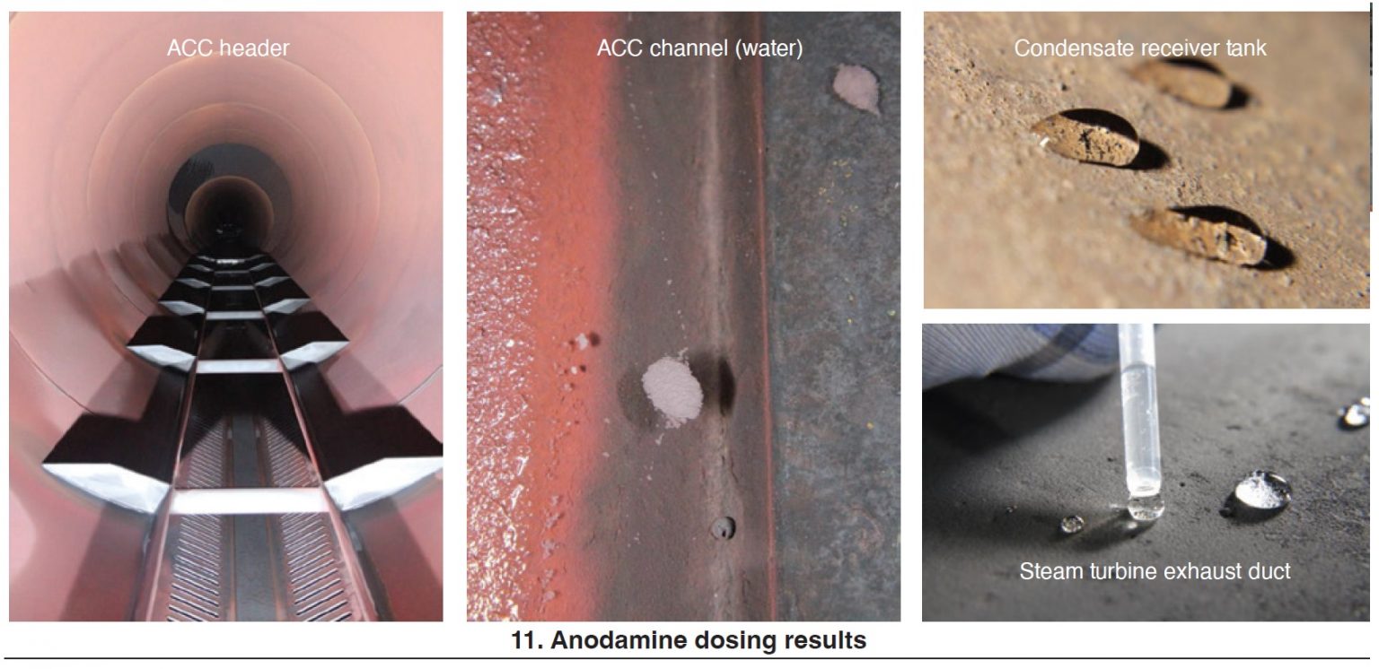

Film formers Anodamine and VPI Power Limited (UK) discussed Use of filming chemistry to improve corrosion protection of flexible operated powerplants. The filming chemical Anodamine has been used to mitigate flow-accelerated corrosion (FAC) and other internal corrosion threats. This presentation focused on plant experience at VPI plants originally designed for baseload operation.
Dosing at one European 2 × 1 combined cycle began in February 2019. The 2021 inspections discussed were tailored to further check the efficacy of Anodamine following positive initial results from the 2019 and 2020 interim and steam turbine outages. Overall, the 2021 inspection results indicate that Anodamine is providing good levels of protection against FAC (both single- and two-phase) and that a benefit to corrosion fatigue and offload corrosion mitigation are also likely.
Internal direct and remote visual inspections have shown build-up of protective Anodamine film in areas susceptible to both single-phase (that is, condensate, feedwater, and the economizer circuits) and two-phase (that is, evaporators, steam drums, deaerator, blowdown/drains and steam turbine exhaust circuits) FAC. Further, repeat ultrasonic thickness inspection of critical areas (that is, HP and LP evaporator risers) shows a general reduction in thinning rates compared to pre-2019 levels (Fig 11).
VPI’s Adrian Bailey explained “As a result of the good performance observed, it is judged that credit can now start to be taken via a reduction (gradual reduction of sample size rather than complete removal) of inspection scope for FAC damage at future outages.”
His conclusions:
  1. Four consecutive outage inspections show progressive improvement in surface passivation/cleanliness; off-load corrosion has been mitigated.
  2. Less iron transport to boilers during two-shifting; reduced boiler blowdown rates.
  3. Cleaner boiler tube surfaces; better heat transfer.
  4. Clearing out of historical oxide deposits; no acid cleans needed.
  5. Ongoing FAC mitigated at HP risers, according to remote inspection and NDT; huge cost saver in not replacing HP boiler risers.
  6. Both operations and management recognize the benefits of Anodamine.
