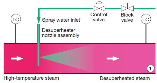

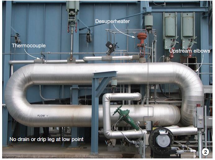

3. Desuperheaters get a significant amount of podium time in virtually every HRST presentation on boiler health. Poor design, leaking valves, ineffective spray nozzles, a lack of instrumentation, and other factors can wreak havoc at cogeneration and combined-cycle plants, putting personnel safety at risk and causing equipment damage that should never occur.
One of the first things to inves­tigate is spray-valve behavior. Is spray-valve position near constant at steady load or does it fluctuate-sometimes closing entirely? If your spray valve is continually hunting-that is, opening and closing dozens of times each hour-the hot/cold cycles eventually will stress desuperheater nozzles to failure and possibly create other damage as well. Control-logic adjustments generally can rectify this condition.
If your desuperheating stations are properly designed and equipped with thermocouples (TCs) upstream and downstream, verify that both are reporting about the same steam temperature when the control sys­tem indicates that the spray valve is closed (Fig 1). If this is not the case and the downstream TC is reading lower than the upstream one, water probably is leaking by the “closed” valve.
Give this immediate attention. Concern is that during startups and shutdowns, water can dribble into the steam piping, collect along the bot­tom of the pipe, migrate downstream to superheater and/or reheater upper headers, and then run down a few tubes. Cooling effect of the water causes those tubes to contract. Resulting stress can cause tube bowing and tube-to-header weld cracks.
Also check plant data to identify times when spraying to less than the saturation temperature of steam in the pipe plus 30 deg F. Do a thor­ough review: startup, steady-state full load with and with­out duct firing, steady-state low load (less than about 120 MW for an F-class gas turbine), and dur­ing transients. Desuperheating to near-saturation temperature creates the potential for damage like that described above for a leaking spray-water valve.
The thermocouple is so close to the desuperheater it gets quenched by water droplets, thereby provid­ing erroneous data. Specifically, operators don’t know how close to saturation temperature that the plant is operating. An improved pipe location for the TC is needed.If your data review reflects the possibility of desuperheater prob­lems and you are unfamiliar with the attemperation station, walk it down while the plant is operating to see if design/installation deficiencies exist. Fig 2 shows a poor desuperheater arrangement. When Stanley flashed this picture up on the screen, he noted the following:
  • The desuperheater is too close to both the upstream and down­stream pipe elbows. Problems cre­ated: Steam flow to the attempera­tor is not uniform and spray water is not fully evaporated before impinging on the downstream elbow. Latter causes fatigue dam­age to the elbow.
  • There is no drain at the low point, allowing water to pool and to cre­ate “water events” during startup.

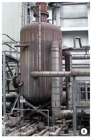

  • Panels do indeed drain completely when drains are open. The ele­vated drain tank in Fig 4 requires sufficient pressure in the drain system to push condensate up into the vessel. Drain tanks located in a pit are better because they allow gravity draining.
Also check to see that HP, IP, and LP drains are not combined in a common collection pipe upstream of the blowdown tank. Reason: Flow through the HP drains could force water back into the IP or LP system if all the drains are open at the same time. Guidelines for proper drain system design can be found in the “HRSG Users Handbook,” published by the HRSG User’s Group (details at www.hrsgusers.org).

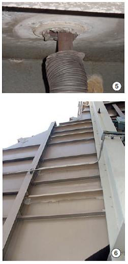

2. Watch for deflection of superheater and reheater floor pipe penetrations during startup and shutdown. Tempera­ture differentials across superheater and reheater tube bundles can cause the panels to bow, exacerbating drain-line lateral movement. Drains that collide with the floor liner or casing often suffer stress-induced cracking.
Stainless-steel bellows have dif­ficulty moving laterally, while fabric seals in high-temperature locations typically stiffen-up. The extra motion created by panel bowing often causes bellows to crack and tear. On fabric seals, bands pull lose and the fabric kinks. Latter creates small holes and leaks that propagate into fabric blowouts.
Fig 5 shows a superheater drain seal that has ripped loose from the floor casing because of excess lateral movement combined with the expect­ed axial motion.
Stanley urged all attendees to also look for “stick and slip” of pipes dur­ing startup-a sign of hard interfer­ence with the floor. He said what hap­pens is that drain lines don’t move much as the superheater warms up and then suddenly-bang-the pipe drops an inch or so. A little while later there’s another bang and anoth­er drop. Such hard contact/expansion interference obviously places unnec­essary stresses on drain lines.

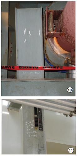

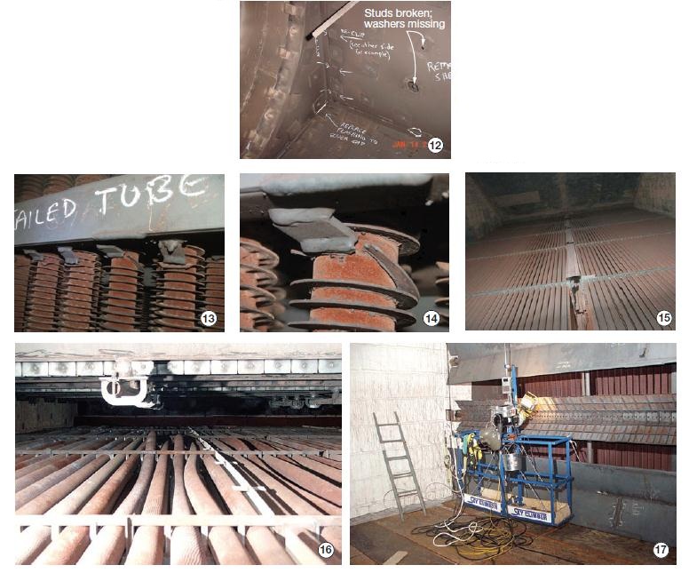

Inlet-duct checklist. Inspect the liner system for loose plates, spinning washers, exposed insulation, and failed studs. Fig 12 is typical of what you might find. Here studs failed and washers were liberated leaving liner plates with minimal support. Once a liner plate moves and a gap is cre­ated between it and adjacent plates, insulation can be sucked into the flow stream. This creates a hot spot in the transition duct skin and allows liber­ated insulation to blind a portion of the SCR catalyst.
Be aware that problems often are experienced with flow distribution plates. Also, check harps for corro­sion, warped tubes, and vibration wear from tubes contacting-that is, banging into or rubbing against-each other when the unit is in ser­vice. Baffles and tube ties should be inspected for vibration damage, wear, expansion interferences, and weld cracks.
Figs 13, 14 show failed tube-fin tab welds that caused “rattling.” Some failed tabs rub directly on tubes. Although no gouges were identified in this case, if condition is left uncor­rected, tube wear will continue (tube-tie components are harder than the tube material). Such wear often is worst at lower elevations, which is convenient because they are easier to access for inspection. Note that the inlet-duct superheater panel in Fig 15 is missing center baffles.

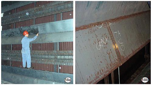

Tube-bundle access-lane checklist. This list begins, like the inlet- and firing-duct checklists above, with the liner system. Same principles apply. Next, tubes and fins should be inspected for corrosion, warping, and fouling. Warping of superheater and reheater tubes caused by poor control of the desuperheating process is rela­tively common (refer back to Fig 16). Warping is also indentified with LP and IP economizers that share com­mon headers with HP economizers (for more detail, access www.com­binedcyclejournal.com/archiveshtml, click 1Q/2008, click “Module, header replacement. . . .” on issue cover.
Look carefully for tube-to-header weld cracking (Fig 22). It can accom­pany tube bowing, but often is found as well on tubes that have not bowed. Tube bowing and cracking usually are caused by the same problem: Wet steam entering the tube field.
Tubes downstream of the SCR are susceptible to fouling by ammonia salts and by rust that flakes off car­bon-steel fin and tube surfaces (Fig 23). The amount of sulfur in the fuel, and in the inlet air, impacts the rate of fouling; so does the amount of time the unit is offline, particularly in a humid environment.
Inspect bundles for wear caused by tube vibration. This will be found most often where tube-tie welds are broken and tubes are free to rattle around (refer back to Fig 14).
Fig 24 shows where baffles are located to avoid bypass of gas around heat-transfer surfaces. If metal dete­rioration is identified, make a note for maintenance follow-up. Also iden­tify and correct areas where expan­sion/contraction adversely impact baffle function (Fig 25) and where baf­fles have slipped down tubes (often because fins have broken off) and cre­ated openings for gas bypass.
As you move back through the unit, Stanley said, look over the upstream face of the SCR catalyst for fouling-typically caused by rust and/or insu­lation fiber entrained in the hot gas (Fig 26). Gas bypass around the cata­lyst limits its effectiveness and could possibly put the plant out of com­pliance on NOx. Be sure to look for poorly installed baffling, open space around the perimeter of the catalyst bed, and gaps between baffling and catalyst frames.
Finally, look for openings between catalyst blocks and between the blocks and frames. Insulation between blocks has been known to compress over time, allowing catalyst bricks to settle. This can create gaps between blocks, especially in the top row of each module (Fig 27). Insula­tion then is free to blow downstream and plug LP heat-transfer surfaces.

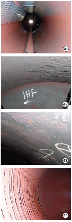

A thorough examination of the drum internal surface demands that you get up close to the metal and look for pits, nicks, cracks, tubercles, cor­rosion, erosion, etc. Take notes and pictures of anything that looks out of the ordinary, Wambeke suggested from the back of the room.
Begin with a color assessment: Red is good in an oxidizing environment (Fig 41), bad in a reducing environ­ment. Next, assess overall drum con­dition, tracking surface defects from manufacture-such as those created while rolling steel for the HP drum pictured in Fig 42. Scaling and lack of passivation during operation is illus­trated in Fig 43.
Has smoothness/roughness of the drum surface changed during the inspection interval? For example, perhaps tubercles have formed (Fig 44). It is particularly important to identify any pitting attack and to inspect what the pits look like under­neath. Keep in mind that pits may corrode under pits, resulting in pits larger than those at the surface.

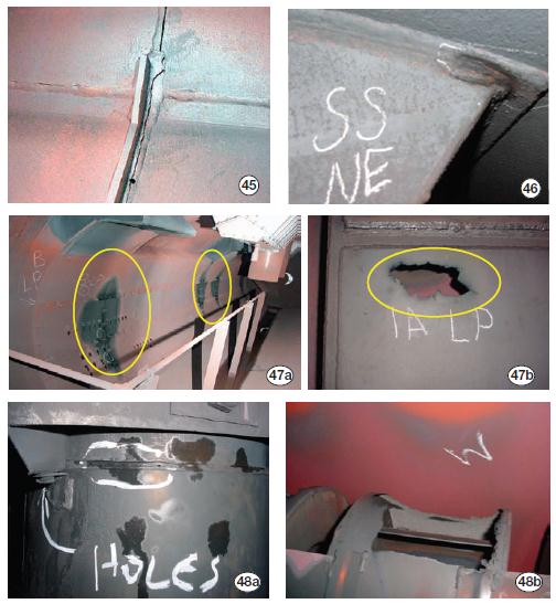

Signs of distress to look for on steam separators and the belly pan include the following:
  • Cracks in the belly pan (or baffle plate), as shown in Fig 45.
  • Cracks in the corners of the final separator (Fig 46).
  • Thinning caused by FAC, as evi­denced by the loss of material on the belly pan in Fig 47a and the hole in the LP belly pan in Fig 47b. Also, early FAC attack on the LP cyclone in Fig 48a and advanced attack (huge hole) on the Fig 48b cyclone.
Ultrasonic (UT) thickness mea­surements are useful for document­ing the condition of drum internals, as well as of tubes and piping. Keep meticulous records to enable rate-of- wear calculations and timely maintenance planning. Standard UT measurements are all that’s needed to quantify material loss.

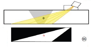

Phased-array UT makes use of multiple fixed-angle transducers in a single probe to quickly and accu­rately characterize flaws to provide the depth of indications, which show up as echo blips on the instrument’s screen (Fig 55). It has become the instrument of choice in GT inspec­tions for its ability to identify even small flaws in complicated geome­tries-such as compressor airfoils, blade platforms, disks, etc.
No work stoppage or welder relo­cation is required to check work because there are no safety haz­ards with UT as there are with RT (radiation).
Leading technology has its price. Phased-array instruments and probes are more complex and expensive than conventional UT and technicians require more experience and train­ing to use it. However, compared to radiography (RT), the old standard in boiler work, phased-array UT offers several advantages, including:
  • Inspections are conduct­ed faster.
  • Better suited for the detection of planar, crack-like indications-such as lack of fusion-which are conducive to premature failure.
  • The exact depth of a defect is revealed, facilitating its removal and rework. Digital RT is making great strides to eliminate or mini­mize this list.
Shear-wave UT is about two to three times less expensive, but does not give depth of indication. Best applications for it are straight pipe, elbows, and circumferential welds.

Attemperators in cycling service should be inspected annually. Look for cracking or distress on the desu­perheater assembly; check nozzles for plugging; confirm liner integrity (see liner crack in Fig 57), and the absence of pitting/wear at the down­stream elbow. If data suggest over-spray, inspect piping for cracks.
