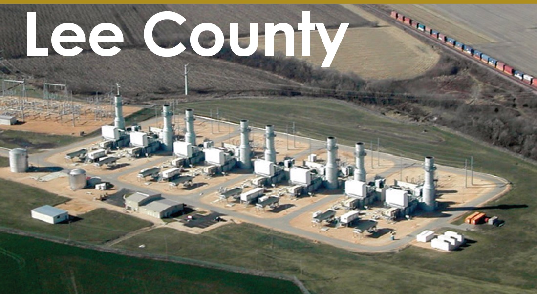

Lee County improves O&M and safety at eight-unit peaker site
Lee County Generating Station
Owned by Rockland Capital
688 MW, 8 × 0 7EA-powered peaking plant operating on natural gas, located in Lee County, Ill
Plant manager: Keith Koziol

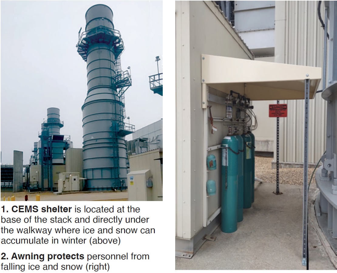

Protecting operators from falling ice
Challenge. Lee County, a peaking plant in northern Illinois, experiences long periods between operations. Calibration cylinders for the facility’s continuous emission monitoring system are located outside the CEMS shelter, only 4 ft from the 90-ft exhaust stack.
Safety hazard: During winter operations, snow and ice can accumulate on the grated walkway the encircles the stack 80 ft above ground level and directly over the space between the CEMS and exhaust stack (Fig 1). Snow and ice can fall unexpectedly from this height to where technicians stand to take pressure readings and replace calibration cylinders, thereby creating the potential for severe injuries.
Solution. The original design had only a small, lightweight, metal awning that barely covered the calibration cylinders. Using a local weld shop, a new larger awning made of heavy-gauge steel was designed and built. Site technicians mounted the new awning to existing mounting points on the CEMS shelter and used Unistrut to support the far end (Fig 2). This awning created a protected area for technicians to stand while servicing the CEMS cylinders.
Results. No one has been hit by falling ice; however, it can be unnerving when a chunk hits the new cover.
