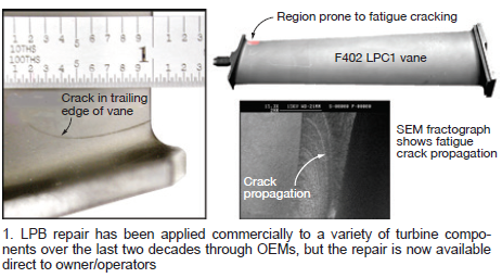

Focus here is on low plasticity burnishing (LPB), a patented shop technique to repair a variety of fixed and rotating gas- and steam-turbine parts suffering from foreign particle damage, stress corrosion cracking, fatigue, fretting, many forms of erosion, pitting, and surface defects generally (Fig 1).
LPB may be unfamiliar to many CC facility staff because it traditionally has been applied private-label, so to speak, through OEMs and other non-OEM services firms. Now, Lambda/Surface Enhancement Technologies (SET), Cincinnati, Ohio, which possesses the patents, intellectual property, machines, and tooling, and two decades of shop experience, is offering LPB-based repairs directly to owners/operators. The company traditionally had been focused on the aviation and defense industries.

In aviation, LPB has been applied repeatedly for similar damage mechanisms to at least a dozen major components of aero gas turbines—including blades, vanes, and discs at multiple stage locations. Many aeroderivative gas turbines in power applications are based on stationary versions of these same machines.
