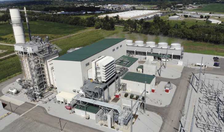

Middletown Energy Center
Owned by NTE LLC
475-MW, gas-fired, 1 × 1 M501GAC-powered combined cycle located in Middletown, Ohio
Plant manager: Dino Padilha
Challenge. Middletown Energy Center faced no operational challenges during its first six months in the PJM market, achieving high reliability during that period. However, it faced freeze-protection issues during the first winter and tripped several times—adversely impacting plant performance. It was imperative that the plant identify and correct the problems to assure reliable and safe operation in future winters.
Looking into the issues that affected the plant during its first winter, staff identified the following four causes:
    • Improper installation of insulation.
    • Failing heat tracing.
    • Improper heat tracing for the application.
    • Inadequate monitoring to allow proactive action.

Solution. Separating the issues in these areas, plant personnel started to define action plans to improve operations and prevent the problems from recurring. Heat-trace protection was the primary focus of staff efforts. Whenever a thermostat failed, an entire line would become unprotected leading to severe impacts on plant operations.
Plan was to replace the existing temperature-sensitive self-regulating (SR) cables with heat-tolerant mineral-insulated (MI) cables that did not require thermostat protection. Thus, heat tracing could be turned on and off based on ambient temperature. The new MI cables covered the tap-root connections of the instruments, assuring these areas also would be protected against freezing.
This was an extensive project with 55 lines (over 7000 ft) requiring upgrade of heat tracing, plus insulation. An additional benefit of the upgrade: Insulation of areas ignored by the original design.
After addressing the issues associated with heat tracing, thermostats, and insulation, staff provided operators the tools both to monitor the health of the heat-trace system while the unit is in service and to alert on possible problems by implementing capabilities incorporated into the plant’s Ovation asset management system (AMS). Note that the Ovation DCS operates in conjunction with Mitsubishi’s NetMation gas-turbine controls and Toshiba’s TosMap steam-turbine controls.
