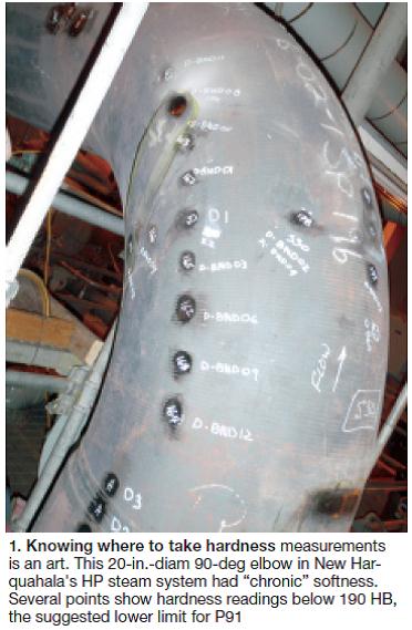

Gressler said that an initial step in current P91 evaluation programs is to screen out the bad material. Specifically, eliminate the outliers – material that clearly has diminished properties. The current range of acceptable hardness for parent metal is 190 to 280 HB (Hardness, Brinell), he added, noting that the upper and lower limits have evolved over time. Weld hardness can be higher.

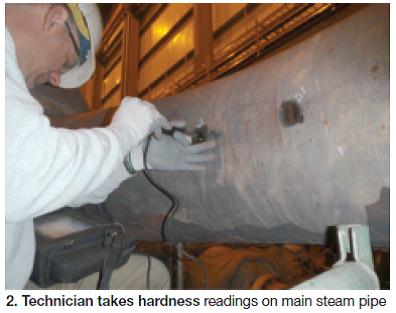

Hardness is only used for screening, Gressler continued. “Hardness by itself doesn’t determine material health, it’s merely an indicator.” Hardness doesn’t tell you when you’re going to have a problem and in that regard it’s much like your cholesterol level.
A baseline inspection is all-important. You must have current material properties to determine both a corrective course of action and how quickly the work must be done. But inspection is not as easy as it might appear.
Knowing where to take the hardness measurements is an art, Gressler said, and data collection an iterative process. If you find some soft material, he added, you have to go back and take more measurements to see how large the affected area is, and how deep (Fig 1). Sometimes the softness is just at the surface in the decarburized layer and the base material is satisfactory.

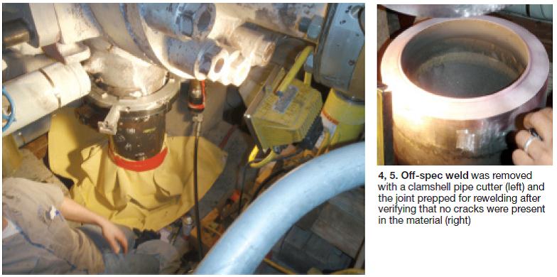

SI’s work at New Harquahala uncovered low-alloy filler material in a critical weld in Unit 2’s HP steam system (Fig 3). Then metallurgists found the same material in the same weld on both Units 1 and 3. Clearly, this was unexpected and of great concern. You can ask yourself, “Why did this happen? How did this happen?” But you’ll probably never know, and the only question that really matters is “How can we correct the situation, and how quickly must we react?”
Background. PMI revealed that the circumferential girth weld joining the P91transition piece in the main steam line to the P91 steam-turbine stop valve was fabricated using 1.25Chrome material (P91 is 9Chrome). Decision: Replace the weld (Figs 4, 5).
The weld repair was not straight-forward because of the difficult location and the different sources of P91 material for the transition piece and the valve body. Regarding the latter, the valve, fabricated to European code standards, was tempered at a lower temperature than that used to temper P91 piping.
Documentation provided by Siemens Energy, which supplied the steam turbines as well as the gas turbines, indicated that for welds requiring heat treatment, the temperature range must be between 9 and 45 deg F below the last tempering temperature of the valve body: 1346F.
Industry experience indicates that exceeding the temperature can damage the base material during post-weld heat treatment (PWHT). However, the Siemens requirement is not consistent with guidelines presented in Section I of the 2009b ASME Boiler and Pressure Vessel Code, table PW-39, which recommends 1375F. But it does conform to the current version of ASME’s B31.1 Power Piping Code.
SI’s position was that the lower PWHT was acceptable but would require a significantly longer time at that temperature than it would at the higher temperature – specifically nine and a half hours at 1346F versus four hours at 1375F. Both the consultant and the plant thought this a reasonable compromise for achieving the required hardness while satisfying the Siemens request.
Hardness tests indicated a successful weld repair. All Brinell values were between 180 and 280 and full transformation to the desired tempered martensitic structure was achieved. More welcome news: There was no damage to the valve. Some softening of the pipe base metal occurred, mostly unavoidable given the extended PWHT soak time.

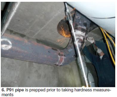

- Map pipe-wall thickness prior to and following surface preparation at hardness test sites, both to confirm material removal to clean metal and that minimum wall thickness has been maintained.
- Map out locations for hardness measurements. They should extend around the pipe circumference at the 3, 6, 9, and 12 o’clock positions on both welds and base metal.
- Prepare locations by grinding only after a hot work permit is in place. A light disk grind of 5 mils or less generally is recommended, followed by use of a flapper wheel 120 grit (Fig 6).
- Test for hardness using the ultrasonic contact impedance method with supplemental testing using pin-Brinell.
- Accept hardness results in the acceptable range of 190 to 280 HB. If hardness is below 190 HB, disk grind 20 mils using a flapper wheel 120 grit to verify that the base material is soft and the hardness reading is not being influenced by surface scale. If the hardness is still low, and there is sufficient remaining wall to confirm that the material would not be compromised, examine further using replication or core or boat sample.
