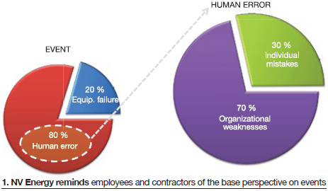

Perspective. The first distinction is to separate human activity from equipment operation and stress. Equipment malfunction or failure reportedly accounts for only 20% of a plant’s reliability loss, human involvement (human error) the remainder (Fig 1).
But the latter goes far beyond errors by individuals. The human-factor category includes collective weaknesses, norms and traditions, management styles and systems, almost anything non-equipment. In fact, most of the human element (seven times out of 10) can be classified as organizational weaknesses—including such strong influences as ownership or management changes.
In that context, a concentration on HPI makes a lot of company-wide sense, and should not be taken personally. It only makes the team better.
