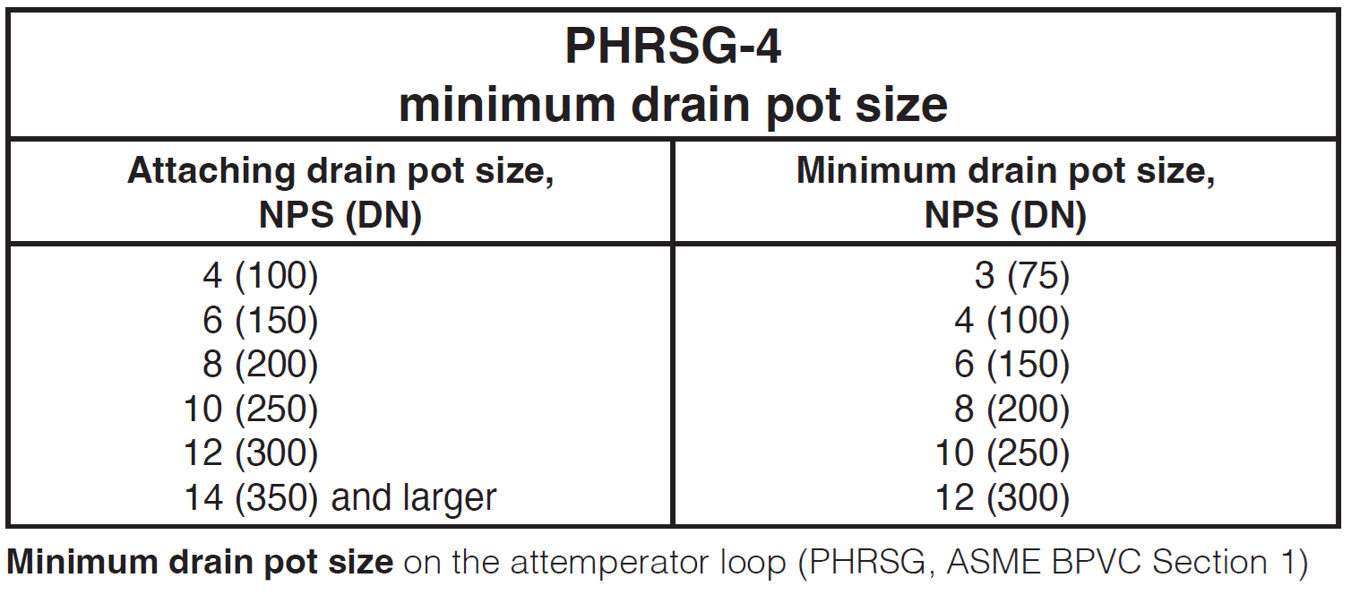

Similarly, if the RH system is being re-rated, the RH attemperator loop must conform with the condensate removal connection requirements stipulated in the PHRSG section of the latest ASME Section 1 Code. This code also dictates the minimum required drain pot size (Table).

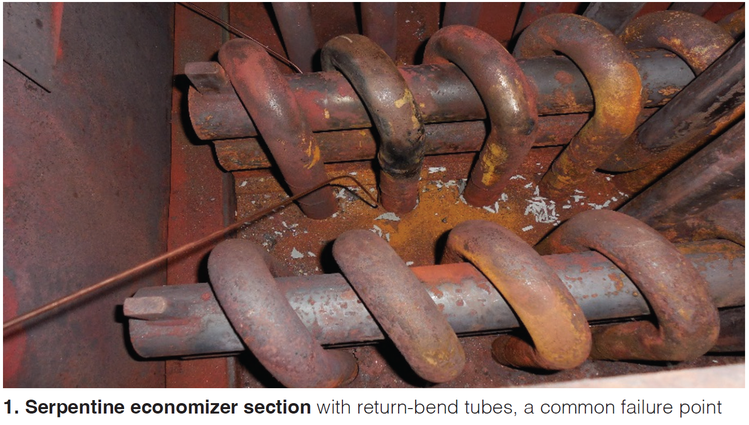

Another important consideration relates to material upgrades and redesigns. For instance, if the re-rate requires a replacement of IP or LP evaporator harps, it is prudent to consider an upgrade to Grade 11 material to prevent flow-accelerated corrosion in the future. Similarly, if the re-rate requires replacing serpentine economizers or preheaters (Fig 1), consider redesigning to a fully ventable and drainable harp.

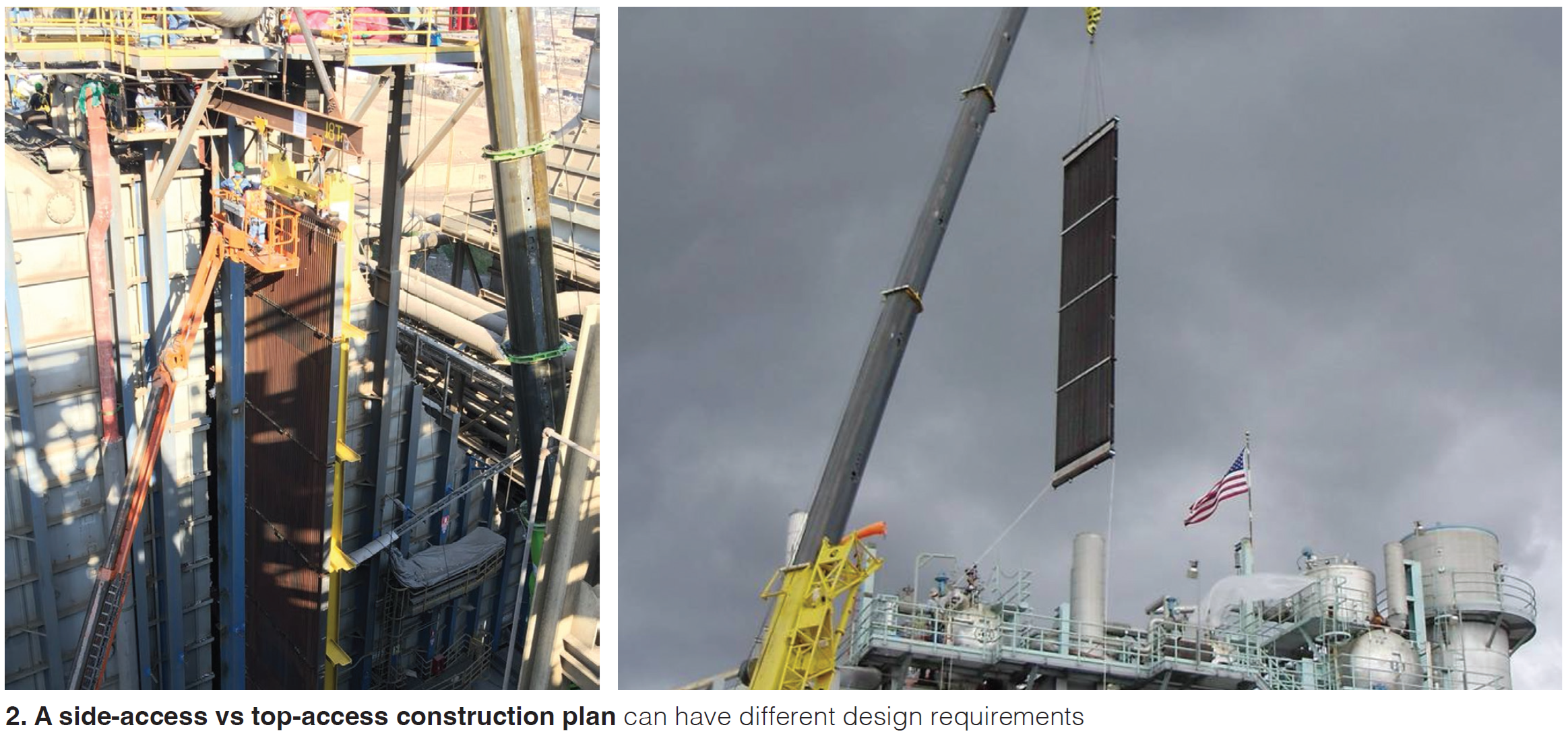

Once the technical scope of supply is fully established, it is crucial to begin early and specific construction planning. A common mistake made during redesigning and re-rate efforts is neglecting constructability until late in the process. The construction plan can significantly impact the design of the components being replaced. For example, a construction plan involving top access to the harps may require a different number and orientation of header lugs compared to a side access plan involving monorail steel (Fig 2).

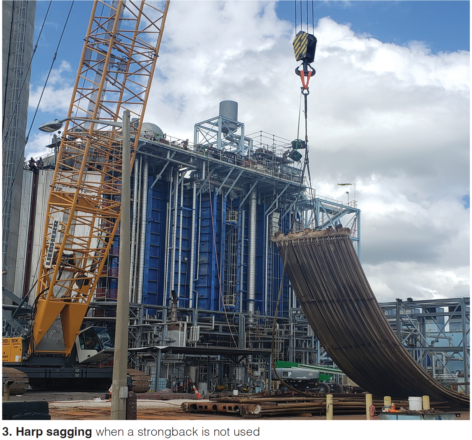

Any special tools, equipment or frames required for installation should also be coordinated with the construction company and discussed at this stage. For replacing harps, strongbacks are often required to upright a harp. Without a strongback, the weight of the finned tubes will cause the tubes to bow and sag during uprighting. The extent of sagging can be seen in Fig 3 where an old harp that was removed from a unit is being lowered to the ground. While this is not a concern on a harp that is about to be demolished, such sagging can place undue stresses on the tubes and tube-to-header connections of the new harps.
