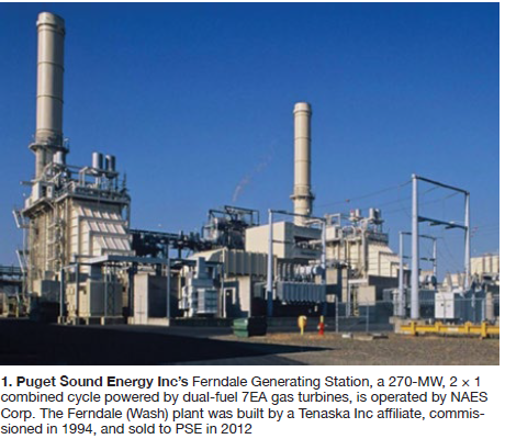

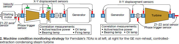

The original machine protection system (MPS) for Ferndale Generating Station’s gas and steam turbine/generators became obsolete in 2014, the year the plant turned 20 years old (Fig 1). The legacy supplier no longer supported the MPS and owner Puget Sound Energy (PSE) planned to replace it and implement a cost-effective machine condition-monitoring strategy (Fig 2). This strategy involved correlating other process data—including bearing temperature, oil temperature, and active/reactive power—with vibration signals to increase the reliability of the diagnostics.

The utility needed a proven and reliable MPS and online condition monitoring capability with no changes to the existing DCS interface. PSE also chose to replace existing transducers with upgraded ones while retaining the original transducer mountings, reuse the field wiring, and fit the new MPS in the same panel cutout as the legacy system.

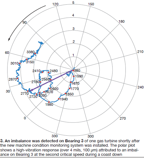

PSE benefits from correlating process and vibration data—improving the reliability of fault analysis and improving root-cause analysis (RCA) results. Coincidentally, the first diagnostic evaluation performed using VC-8000 occurred during a training session when a machine fault was suddenly detected: An imbalance occurred on Bearing 3 of one gas turbine. Personnel were notified of the issue immediately, enabling an expeditious assessment (Fig 3).
