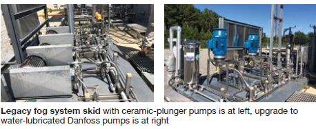

The discussion began with pumps. Ceramic-plunger pumps often were specified for the early fog systems, with many installed during the “bubble” when about 200,000 MW of gas turbines were commissioned at simple- and combined-cycle plants. These pumps suffered from premature seal failure because the demineralized water used for fogging is a poor lubricant. The legacy pumps can be replaced with newer seal-flushed pumps, which can operate up to 6000 hours between seal changes. Mee has upgraded many fog pumps to seal-flushed pumps over the past several years.
Water-lubricated pumps, another upgrade option, can run up to 8000 hours between rebuilds and eliminate the need to change pump crankcase oil every few thousand hours.
The left-hand photo shows a typical skid with four legacy ceramic-plunger pumps which were replaced by the two water-lubricated Danfoss pumps at the right. The new arrangement is designed to easily remove a pump at its 8000-hr maintenance interval and install a spare (often a rebuilt pump), allowing for a shop rebuild by experts to reduce in-plant maintenance requirements. Mee has converted skids serving three dozen engines to Danfoss pumps.
