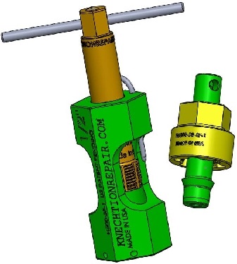

The manual thread-chasing tool Knecht developed is designed to repair both the male end of the fitting and the female captured nut on the tubing at the connection location. It is compact and can be used in space-challenged locations, right at the point of connection, as the video illustrates. The tool includes a holder to restrain the nut on the tube in concentric alignment with the thread-chasing hollow-bore tap, which is turned manually to repair/clean the damaged threads.
For the male end, a thread-chasing die with a concentric alignment hole is used in conjunction with an alignment pilot inserted in the fitting. The die, held in alignment by the pilot, is turned manually to repair/clean the damaged threads. After the repair, the pilot is removed and the fitting is ready for assembly.
