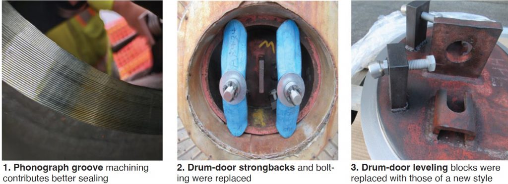

Challenge. The HRSG high-pressure drum doors had a history of leaking. Some leaks caused forced outages; all leaks represented safety hazards for employees.
During annual outages, the drum doors were a challenge to close and seat properly for several reasons, including these:
  • Bent and worn drum-door hinge hardware, which often caused misalignment of the door-to-drum connection.
  • Pitted drum and door seating surfaces allowed a pathway for steam to leak.
  • Worn drum-door bolts and strongbacks resulted in over-tightening (over torque).
  • The heavy weight of the doors required personnel to use pry bars and wood blocks to center the drum doors in the drum opening (the existing drum-door leveling blocks did not perform well).
Solution. River Road is a baseload facility with very little downtime. Thus, all remedies listed below were implemented at the same time:
  • Performed “phonograph-groove” machining on drum manway and door gasket sealing surfaces (Fig 1).
  • Replaced the drum-door internal hinge assemblies.
  • Replaced drum-door strongbacks (Fig 2).
  • Replaced drum-door bolting with Superbolt™ and nut design.
  • Replaced existing drum-door leveling blocks with an improved style (Fig 3).
  • Completed machining and installing all parts during a single annual outage.
Results.
  • Performed several startups and shutdowns post-outage with zero leaks to date.
  • Project provided the opportunity for team participation and collaboration to identify all related issues and research potential solutions.
  • The new drum-door leveling system works perfectly.
  • The Superbolt and nut system ensures proper torque is applied to drum doors and can be accomplished with a small ratchet torque wrench.
  • Enhanced safety was achieved for all personnel working near or passing through the vicinity of the drum doors.
  • The physical effort and time required for opening and closing drum doors was reduced significantly.
