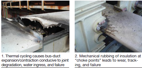

Moisture from condensation and/or water intrusion attributed to poor joint design and/or fatigue (Fig 1) is a catalyst for insulation degradation and associated tracking. Conductor insulation can rub at so-called choke points and wear until tracking and failure occur (Fig 2).

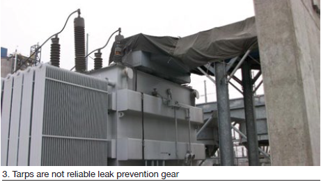

Many users have installed water-intrusion prevention gear—from tarps (Fig 3) to elaborate rain hoods—over their non-seg duct. Not all mitigation efforts have been successful.
